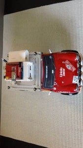

Introduction: Car No.02 Steering Wheel Drive R/C Car With Arduino, Webcam and Net.USB Etc.
IP Control Car was launched in 2001.
I make the similar function car utilizing commercialized products.
The concept of Car No.02 is to utilize commercialized products, and I am an amateur in electrical. So, do not blame me that the system is not sophisticated, i.e. servo & speed controller control system and webcam system are not integrated, or 4 different types of batteries are used for R/C Car(7.2V), Arduino(5V), USB Device Server(12V) and Wireless Broadband Router(5V).

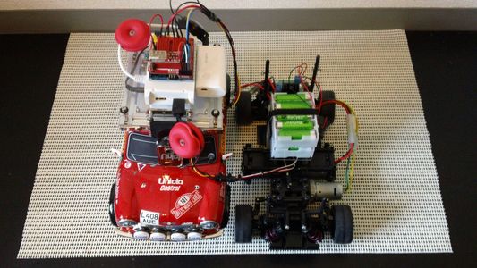

R/C Car
- Chassis Tamiya M-05Ra Chassis
- Body Tamiya 8085258 Mini Cooper Monte Carlo 94 Finished Body
- Geared Motor AO-8014 Tamiya Geared Motor 380K10 (gear ratio 10:1)
- Servo Futaba S3003
- Speed Controller Tamiya TEU-104BK
- Ni-Cd Battery 1500mAh 7.2V

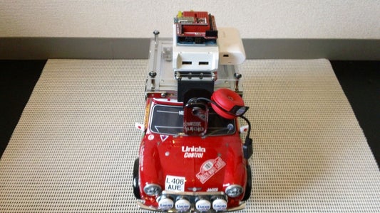

Mounted devices on R/C Car
- Arduino Duemilanove
- Arduino ProtoShield Kit DEV-07914
- Bluetooth Modem BlueSMiRF
- 5V 500mA Battery eneloop mobile booster KBC-L3AS
- Webcam Microsoft LifeCam Show RLA-00007
- USB Device Server IO Data ETG-DS/US (net.USB)
- Wireless Broadband Router PLANEX MZK-MF300N
- 12V 1A Low Dropout Regulator LM2940CT-12 kit
- 5V 1A Low Dropout Regulator LM2940CT-5.0 kit
- AA battery x 20
- Battery Case (AAx10pcs) x 2
- Lubic, etc

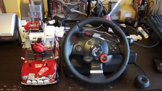

Desktop PC side (OS is Windows XP.)
- Steering Wheel Logicool Driving Force GT LPRC-14000
- Bluetooth USB Adaptor Parani-UD100
- Wireless LAN USB Adapter GW-US300MiniS
- Wireless LAN Extender PLANEX MZK-EX300N-EZ

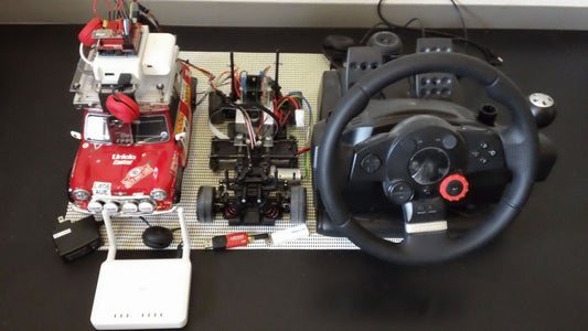

Step 2: Assembling 1
Assemble Tamiya M-05Ra Chassis in accordance with Assembly Manual. (http://www.tamiya.com/japan/download/rcmanual/m05ra.pdf)
The followings are different from the manual.
- Geared motor installation
  (if you do not want a low speed car, geared motor is not necessary. Assemble with 540 motor in accordance with the manual.)
  Modify A2 and B2 parts, and attach the geared motor with following parts;
Different diameter in-line collar 6mm x 4mm
Dia 4mm hollow shaft 10mm long
Dia 3mm shaft 19mm long
16T pinion gear
Adjuster 20mm long
Countersunk screw
  Skip Part 11 and 12 of Assembly Manual.
- Get the center value of servo and set up speed controller
  Instead of Part 19 of Assembly Manual (Checking R/C equipment), get the center value of servo and set up speed controller with connecting them to Arduino. Receiver is not required for this system.

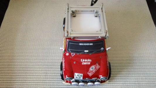

- Body
  Make holes and attach Lubic mount.
Step 3: Assembling 2
- Solder, assemble and mount 12V 1A and 5V 1A power supplies for USB device server and wireless broadband router respectively.
  Solder the following parts, assemble, and mount on R/C car chassis with double-faced adhesive tape and hook & loop fastener.
  Parts
Board
Low dropout regulator kits (12V 1A and 5V 1A)
Resistance
LED
Switch
Terminal
Heat Sink
- Set up wireless broadband router. (Refer to the set up manual. Changeover switch shall be ‘AP’.)
- Attach wireless broadband router, USB device server and eneloop battery on acrylic plate with double-faced adhesive tape, attach   duino+ProtoShield+Bluetooth Modem on USB device server also with double-faced adhesive tape, and fix the acrylic plate on Lubic mount.
- Attach webcam in front window of R/C car.
  (Webcamera is attached upside down. In Processing code, upside down is adjusted.)
- Wiring/Connect
  Connect servo and speed controller to Arduino.
  (Servo --> D9, 5V, GND Speed Controller --> D10, 5V, GND)
  Connect eneloop battery to Arduino.
  Connect webcam usb connector to USB device server.
  Connect USB device server and wireless broadband router with LAN cable.
  Set battery cases with batteries and connect to 12V 1A and 5V 1A power supplies.
  Connect 12V 1A power supply to USB device server with DC plug (outer diameter 5.5mm, inner diameter 2.5mm)
  Connect 5V 1A power supply to wireless broadband router with DC plug (outer diameter 3.4mm, inner diameter 1.3mm)

- Install driver and connect Steering Wheel.
- Install driver and connect Bluetooth USB Adaptor.
- Install driver and connect Wireless LAN USB Adapter.

Step 6: Let's Drive!
R/C Car side
- Switch on 12V and 5V power supplies, attach Car Body to body mounts and fix it by snap pins, and switch on R/C Car(7.2V) and eneloop(5V).
PC side
- Establish Bluetooth connection.
- Establish Wireless LAN connction.
- And await for net USB connection. (It sometimes takes more than 10 minutes!)
- After these connections are established, run the Processing code.
  Once video capture appears, press ‘s’ key to start serial communication.
  Vertical and horizontal lines are indicated on the video captured screen.
  Pull the gear shift lever for forward and push it for backward.
  Break pedal for break and accelerator pedal for accelerator.
  The break is set weak. If you want sharp break, adjust the figure in the processing code.
if(slider2.getValue()<0){y = constrain(y + slider2.getValue()*8*k,height/2,height);}
if(slider2.getValue()<0){y = constrain(y - slider2.getValue()*8*k,0,height/2);}
  Press X button on the wheel steering for emergency stop.
Step 7: Reference, Notes and Trailer
Reference:
http://kousaku-kousaku.blogspot.com/2008/06/processing-arduino.html
http://kousaku-kousaku.blogspot.com/2008/06/arduino.html
http://kousaku-kousaku.blogspot.com/2008/10/arduino-processingbluetooth.html
Notes:
Since the speed controller Tamiya TEU-104BK does not function well for the change from forward to backward, I elaborated the Processing code for that change, but it takes several seconds to start backwarding after setting the shift lever backward.
Logicool Webcam series are not recognized in net.USB.
Problems yet solved:(Yo Dareka Oshietekure!)
Net USB connection for Webcam takes so much time. Dose anyone know how to establish net.USB connection for Webcam quickly.

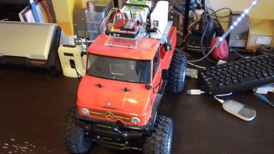

Trailer for Car No.03
Car No.03 is Crawler type!
