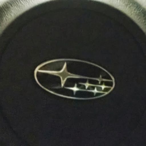

I, like many car enthusiasts, had an OEM headunit that is a touchscreen with a fairly sizable display that lacks an aux input functionality. My car specifically is a 2013 Subaru BRZ (aka the FRS, aka the GT86), but I will attempt to write this up in a generic way to assist those with cars from any manufacturer that gives you rear view camera functionality, but no aux input functionality.
