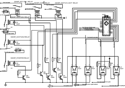

//This sketch for remote start any car //Car with automatic transmission only //version 1.0.0 //WITHOUT ANY WARRANTY //Without delay(); //Created by: MUS(KNOCK5700),1 Aug 2021 //you can press button A in remote to start the car //you can press button A in remote and press brake pedal to moving the car from starting by key to remote start //you can press button B to Turn off the car when a remote start is active //you can press button C to horn while remote start is active only //you can press button D to horn and light every time

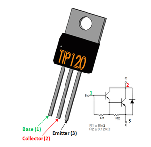

TIP120 transistor 1PCS

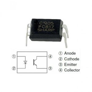

PC817 Optocoupler 4PCS

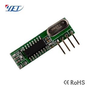

RF-Receiver-Module 1PCS

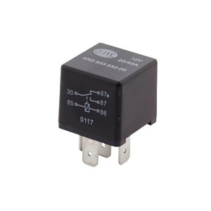

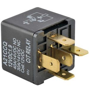

automotive-relay-30amp 3PCS
automotive-relay-20amp 3PCS
Circuit by MUS
