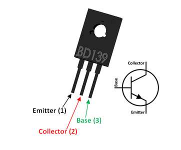

Step 2: Transistor Pin Out
The BD-139 is an NPN complementary low voltage NPN transistor in 3 pin SOT-32 package. Products are pre-selected in DC current gain. Collector to emitter voltage (Vce) is 80v and collector current (IC) is 15A.
We know the transistor have 3 legs. If we count its leg from left side then 1st leg Emitter, 2nd leg Collector and 3rd leg Base.

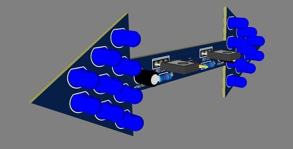

Step 4: Schematics and PCB Design
The schematics of PCBs can be
seen above.
