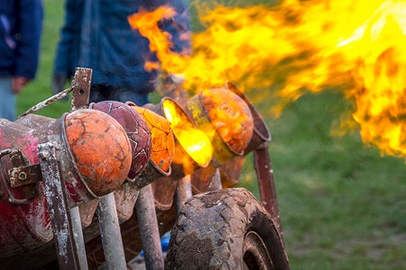

My canon (container) has a volume of 1.83 liters.
Carbid explodes only in a mixture with air between 15% (LEL) and 82% (UEL). Above and beneath there will be no boom. A safe level of gas is about 60%.
With my container that will be 1.1 liter.
Instead of using 64 grams of carbid necessary for 24.5 liter gas, I will use a ratio of 1.1 / 24.5 x 64 grams = 3 gram
The use of water will be the same ratio. 1.1 / 24.5 x 36 = 2 g = 2 ml
Step 4: Recipe
The recipe is not very precise but in the wrong amount of Carbid and water there will be no explosion. The better the quantity and ratio between the component the more powerfull the explosion will be.
  1. First place a lump of Carbid in the container
  2. Then add water in the right amount ( I used a syringe )
  3. Put the ball in the explosion opening
  4. Wait for two minutes
  5. Ignite
  6. BOOM
