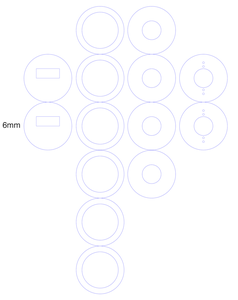

Step 2: Laser-Cut the MDF Disks and Spacers
The role of these disks and spacers is to create a block that firmly holds the smaller tube in the bigger one, and hold the USB connector that will be pushed into the USB socket of the powerbank. The four small holes are there to loop the wires as a pull relief before running them through the smaller tube.

Step 5: Assemble the Stack
Insert the smaller tube through the five topmost disks ans spacers. Loop the wires through the small holes and solder the ends to the outer two pins of the USB connector. If unsure, check the polarity using a multimeter by inserting the USB connector into the powerbank.
After soldering, add the last two disks and glue the stack together. Also glue the disks to the carbon tube. While this makes it more complicated to access the components in case of failure, but under realistic conditions, the tube will probably be pulled out of the disks.
