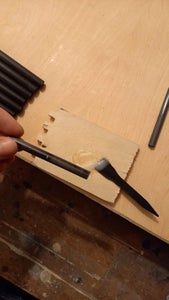

Step 2: Sanding of Inner CF Tubes
In this step you should sand the inner tube. It is necessary to sand only the half of the tube, which will be inside the other. Sanding will improve the strength of glue. Next thing to sand is the cut part of the outer tubes.

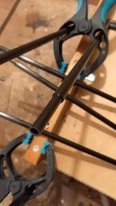

Step 3: Gluing CF Tubes Together
Now you should glue half of the inner tube (ground part) and put it inside the outer tube. Before gluing I made a mark in the middle of the shorter (inner) tube to easily recognise where the middle is when you put it inside the other. You don't need to use excessive amount of glue.
I used Two Component Epoxy Adhesives, which I found is good for CF.

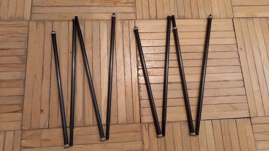

Step 4: Assembling
For this part you need to print the attached 3D models (I included STL). Those models are first iterations and they could be improved (I was thinking about a metal screw in the tip in the ground). I started with the bottom tip where I made a simple knot and threaded through the CF tubes. Tubes should be oriented upward (so the glued inner part is facing up - and the last tube is without an inner part). On the top tip (rounded one) you should tighten the elastic cord a bit (but not too much) and make a knot.
Step 5: Fixing of Errors
As I mentioned in the first step. I accidentally bought particles carbon which is not stiff enough. So after I used those poles, one of them exploded. The outer tube was torn by the inner tube (weakest point). But overall the tube seems to have enough flexural strength. The problem is with structural strength. So I printed small rings and installed them on the bottom of all outer tubes. It seems that this solution reinforced tubes enough and it survived another night. But I highly recommended to use better CF tubes.
Step 6: Conclusion
I used those poles for 3 nights in my Lanshan tent and after the last modification I'm satisfied. I used it on calm nights so first storm will verify the stiffness of the poles.
