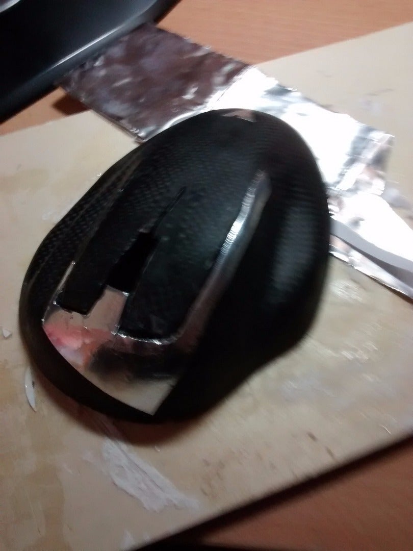

I know this isn't the proper way to use carbon fiber.. but this easy method works. The use of an oven is actually optional, and making a vacuum on such a complex shape is a little too difficult, isn't it? There are some tiny tiny bubbles in the resin, yes, but the result looks acceptable to me.
- First, coat the mould with the wax and let dry.
- In the meantime, cut the carbon fiber cloth and the thin fiberglass in convenient shapes for your mouse.
Please note that the carbon fiber cloth is more flexyble and ductile than fiberglass, because the cloth can shift and be made a little slanted.
It's really hard to cut carbon fiber without making a mess of it. To get better results than I did, I suggest you put a thin strip of transparent tape in the back of the cloth, and then cut in the middle of the strip. This way the cloth won't disintegrate, but it will be harder to bend it! - Prepare and stir the resin.
- Put your pieces of carbon fiber in the mould and soak it with resin. Possibly make two layers of carbon, then proceed with the thin fiberglass: add another 2 or 3 layers. Add 4 layers if you did not shape the buttons in the mould.
Tap each layer with the brush, and BE VERY CAREFUL NOT TO LEAVE ANY AIR BUBBLE! - cover with baking paper and press out the air towards the outline
- Let polymerize until completely hardened.
- detach from the mould
- clean from any residue of wax
Step 8: First Improvements
- clean the cast, cut the excess fiberglass/carbonfiber
- If you still are without buttons, cut them out carefully with the dremel saw for plastic. If you already have them, clean out the excesses so that they can move smoothly. Grind underneath the buttons to make them more flexible. Proceed with care, so to make them as light as you like. Take another mouse for reference.
- grind/sand the outskirt (?) of the mouse to make it as flat as you can. I found this very difficult!! it helps to mark with a marker pen how deep you should grind in any point.
- cut a little hole for the cable (if you're making a cable mouse) in the front of the mouse. I used a small mill.
- cut to pieces of plastic (I used the carcass of the old mouse) to make a bar to click on the switches.
- hotglue said pieces into place. Try to keep them parallel to the plane on which you think your switches will lay.

- if you want you can apply some stickers. I cut some shapes from aluminum tape.
- spray it with transparent acrylic varnish. Spray from a distance of at least 20cm, slowly. You don't want any drop to coalesce.
- follow the instruction on the spray can for applying a second coat. Apply at least 2 coatings.
