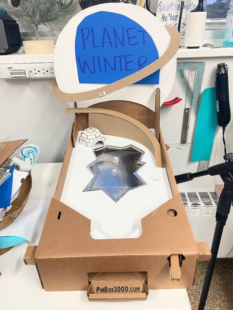

My pinball machine tells the story of a group of super-smart penguin astronauts who were fed-up with global warming and left earth to live on "Planet Winter" - where it's winter all the time! The snow, blizzards, icebergs, avalanches, and icy lakes make it the perfect penguin paradise.
Step 2: Playing Up the Drama and Scale

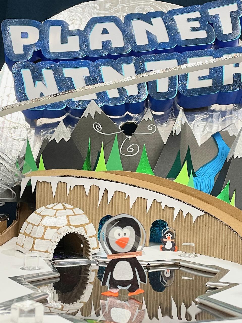

I wanted the game to have depth and multiple levels of interest. I added a large round piece of cardboard to the backplate to create the "planet" and to make a large enough space for the "Planet Winter" game sign. Then, I cut a hole in the playboard to serve as a lake and give depth to the scene.
Step 3: A Big, Bold Sign
My favorite arcade games have large illuminated signs with bold letters, so I wanted to incorporate a big sign into my design. Using my Cricut Maker, I cut out the "bubble" letters from paper and used translucent paper in the center so that I could backlight them with Neopixels. I ran paper around the edges to make them 3D and to give some space between the pixels and the paper so that the letters illuminate evenly! What fun neopixels are - now I could make the sign any color that I wanted, even rainbow!
Step 4: Making Cardboard Ramps for the PinBall to Travel On
I tore one side of the paper off of corrugated cardboard to make it flexible enough to make ramps. I also used the center of a cardboard tube as a shoot around the side.
I added some paper mountains and created the illusion of distance by using lighter grey mountains in the back and darker mountains in the front to play with atmospheric perspective.
Step 5: Making Paper Penguins
I illustrated the penguins on silver paper with a black Sharpie, and added detail back with a silver Sharpie. I used orange paper for the beak and feet, white paint for the eyes, and craft plastic with copper tape to make the penguins their tiny space helmits.
