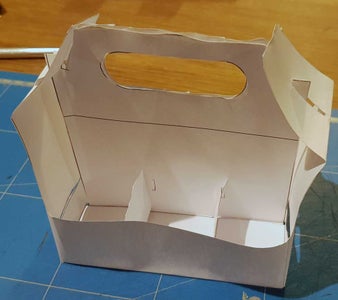

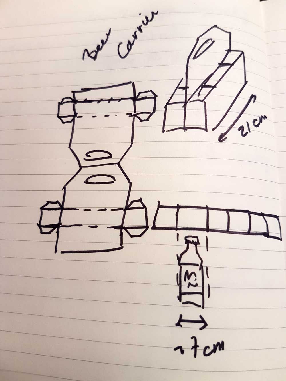

Designing the carrier was not simple and some tricky parts had to be taken into account. After several trials and errors (pics present you the path from first sketch to actual CAD), I ended with a design that completely suited my needs.
I had 2 major objectives:
- making it as simple as possible, ==> checked
- avoiding any use of glue ==> failed (even if I have some ideas to achieve this one)
To achieve those goals I used the principles of Origami and Fusion360 (not as easy as I thought to use it. It was necessary for me to find a tutorial despite my, let's say, standard knowledge of CAD software...). The Most challenging part was to make the folded cardboard strong enough to carry 6 beers incl big glass bottled ones.

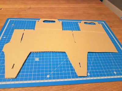

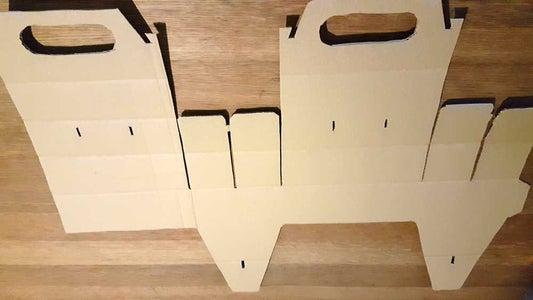

Step 3: Option 2: Cutting the Cardboard With an Utility Knife
If you don't have access to a laser cutting machine or if you prefer doing it by hand, let's go!
First print the pattern. If your printer cannot print it as once, trim them down to cut the shape outlines and just taped the corresponding pieces back together to make the larger shapes whole again (just how I did it).
I didn't really take care of the corrugation direction in my project and it seems to work quite well anyway so I suppose that it did not really matter. Please share your comment about that specific point if you find out that corrugation direction is important.
One can use a spray glue (or glue stick) to stick the paper templates to the cardboard.
It is ok even if I prefer to pin it and/or report the shape using the utility knife and then cut it. One can also use a pencil to report the shape taking care not to damage the cardboard.
Then use your utility knife, with the appropriate care, to cut the general shape of the carrier. Take care to protect your table or whatever you are cutting on with a cutting mat or a sacrificial piece of cardboard.
Hint from the field when cutting cardboard:
I really engage you to cut your cardboard in two steps. With your utility knife and ruler, first cut along your line without applying to much pressure. Then make a second run to finish the cut. It will ease the cutting and will decrease the chance of false cuttings.

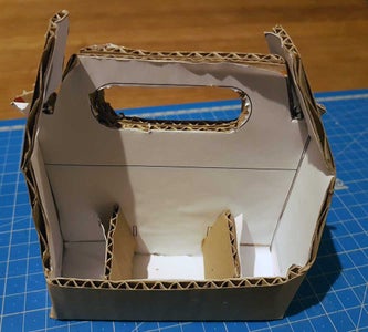

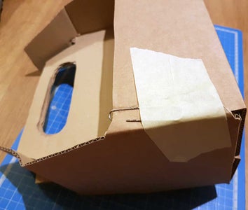

Step 4: Folding
Once you have the cut cardboard, it is time to fold it.
Mark the folding lines with whatever round-ended tool you could have or (preferred) a ruler.
Then start folding. To let you understand how to fold it, please see the provided PDF.
Don't forget to glue the dedicated part as it will look your carrier. I use masking tape to maintain the parts while the glue is curing.

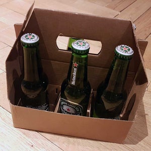

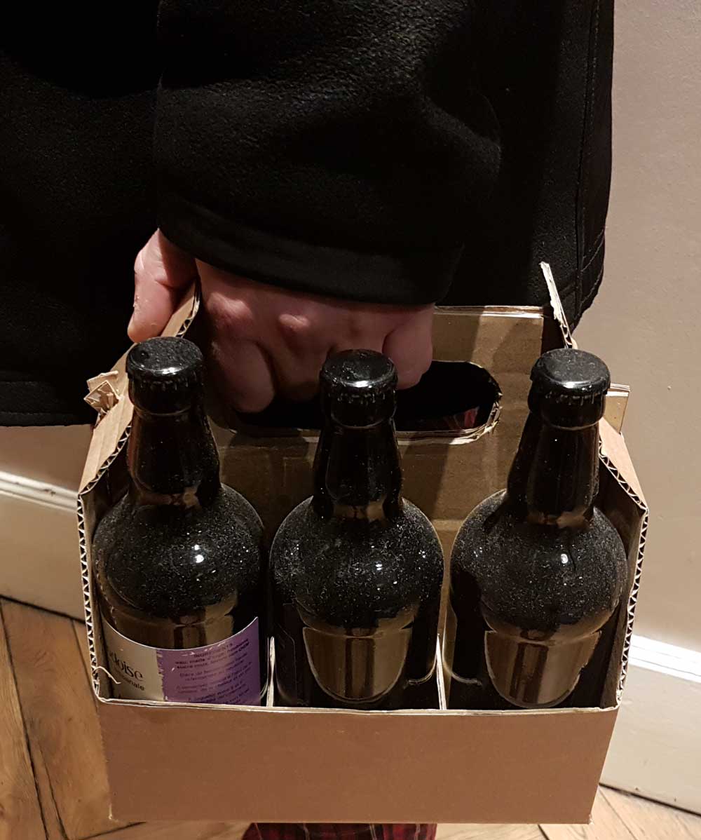

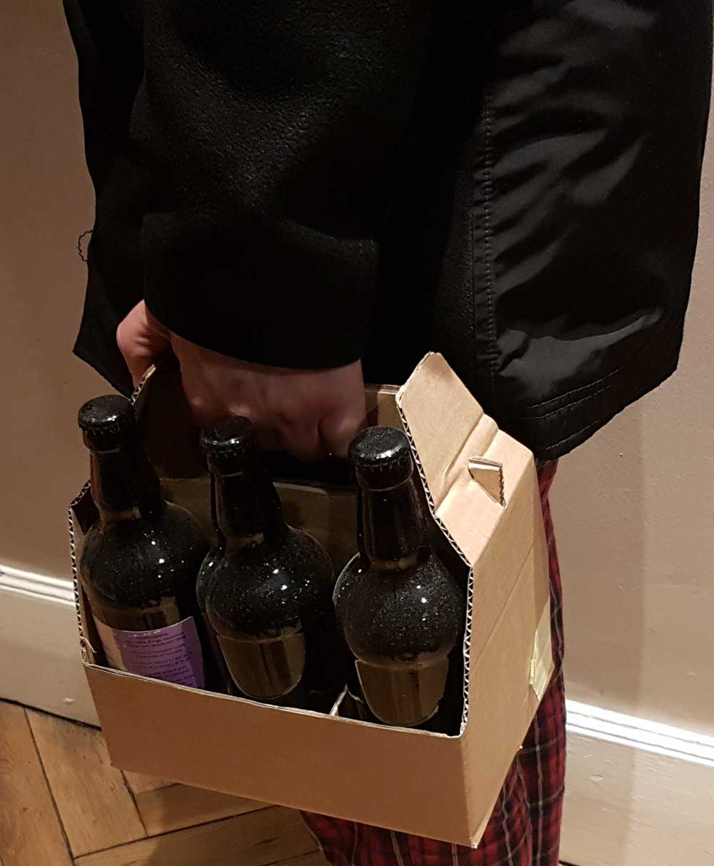

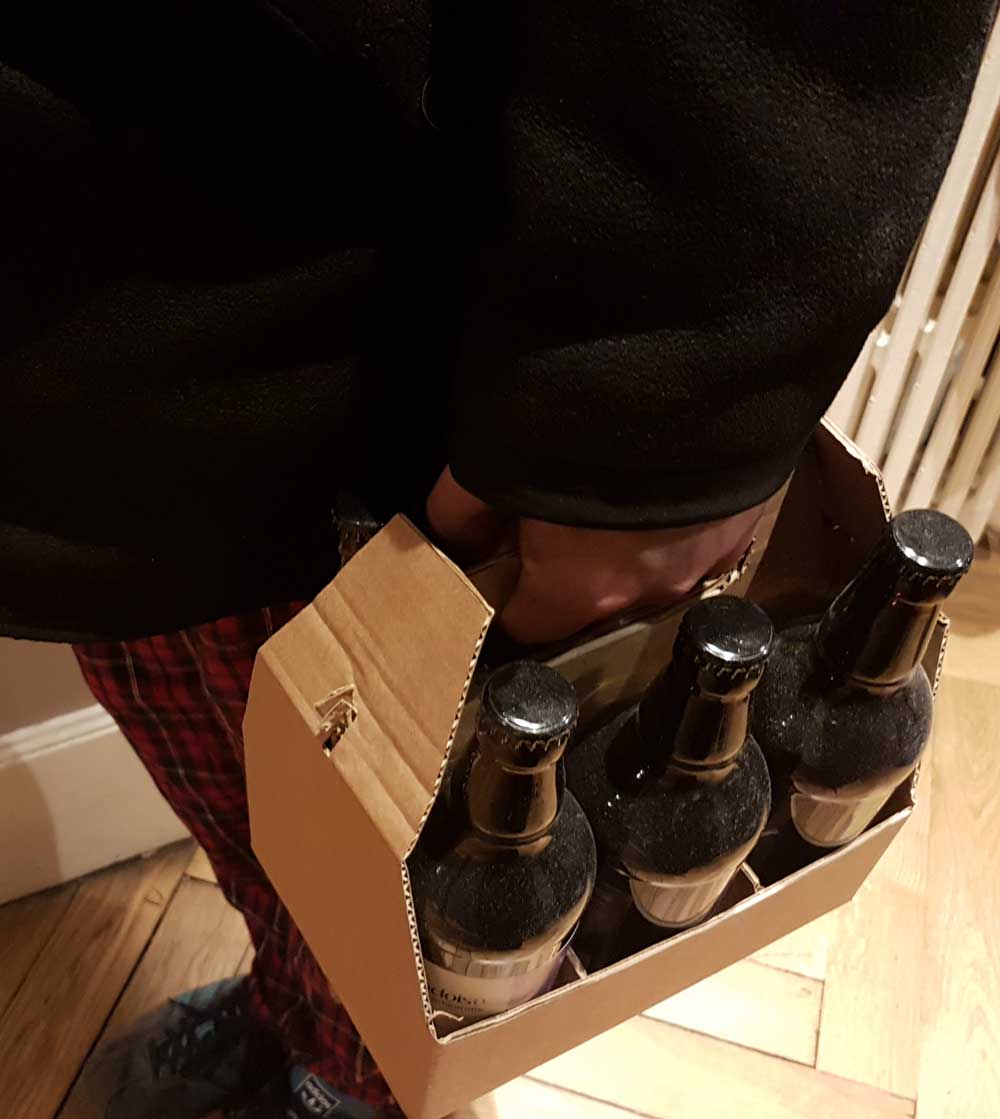

Step 5: Celebrating & Sharing a Beer
Final step is the most enjoyable one.
Put your local beers into your carrier and run to your friends house to spend good time together...
Enjoy your drink (with moderation) ;-)
