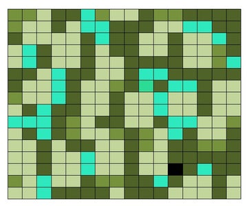

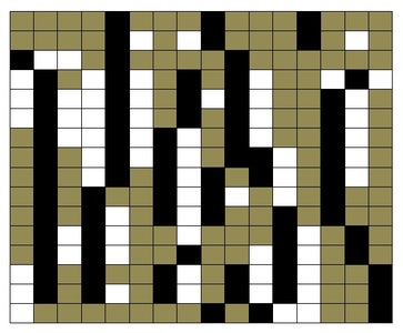

Next, make stencils to use to decorate the boxes.
There are plenty of ways to design your stencils; if you're a Minecraft enthusiast you can probably freehand it. You could also download the tree skin images from the game itself. I looked very closely at the design on these trees (http://thegoodness.com/matt-and-asias-minecraft-wedding/) and made the patterns on the attached images. My boxes were 1 foot square, so I made a grid that was 1 foot square, 16 boxes across and down, each box 3/4 inch.
Using a ruler I made these 16x16 grids on 4 sheets of posterboard with a pen.
Then I carefully colored out the boxes for each color - one for black, one for forest green, etc.
Using shipping tape, cover the grid of each posterboard - this is to reinforce and support the posterboard.
Using exacto knife cut out the colored squares of each posterboard.
You should now have a stencil for each of the colors: black, white, forest green and teal.
I wound up making 3 stencils for each because using spray paint they wore out quickly, and would then warp, and the color would bleed around the stencil, and that is a hard thing to fix.
Once again let me encourage you to use markers or tempura paint or anything other than spray paint. That respirator in the picture, you will hate it in no time and it won't protect the people, pets, plants around you from those noxious fumes.

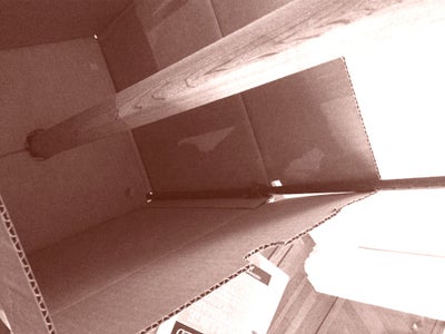

Take your 6 decorated trunk boxes and on each of the flaps cut a semi-circle from the middle edge. When you collapse the flaps they will encircle the center pole.
Bring a trunk box over the top of the pole and bring it down to the base.
Hot glue the box flaps closed around the center pole. Don't glue the boxes to the pole, just glue the flaps closed. Do this for the top and bottom of the box. Now bring another box over the top. Glue the bottom flaps closed. Now glue the two boxes together. Repeat for all 6 boxes.
Optional:
I ran two thin plastic poles down through the boxes on either side of the main support to keep the column square. I think you can keep the boxes lined up without them, just with glue.

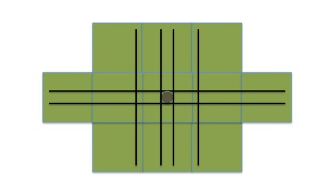

- Bottom layer: 3 boxes by 3 boxes
- Middle layer: exact same layout as bottom
- Top layer: 2 boxes by 2 boxes in a cross formation.
Important Note: Where is your tree's final destination? How many doorways will it need to pass before it gets there? How wide are those doorways? I found most doorways are in the 2' - 2.5' width, not 3ft wide. Do not make my mistake of building branches wider than doorways. It's sad to prune your tree.
- Take the Branch Support Assembly that you made in the last step and run it through the middle row of the bottom boxes. You will need to cut holes in the boxes to insert the Assembly. Hot glue the Assembly to the boxes.
- Now attach all the bottom level boxes to each other. First hot glue them together, then further support with wood slats that are 6" long, 1.5" side and 1/4" thick.
- To attach the adjacent boxes to each other, I put wooden slats in the boxes aligned with each other. I then put screws through the whole thing--first wooden slat, two layers of cardboard, wooden slat on the other side.
- Add the second layer of boxes to the bottom layer, hot glue them in place.
- Run 4' dowels through the layer, perpendicular to the support assembly and screw them to the assembly where they cross.
- The top layer of boxes you just hot glue in place at they do not that extra structural support of dowels and slates.
