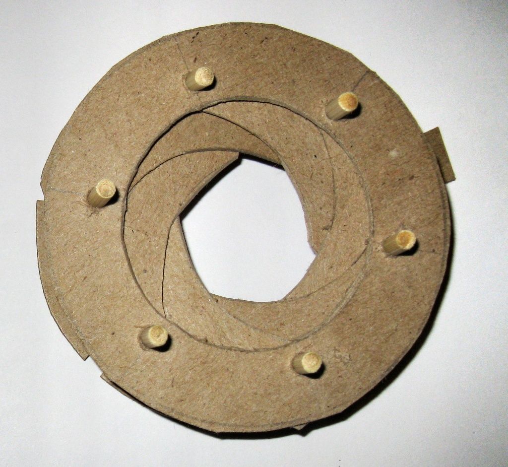

Step 5: And You're Done!
Just place the adjuster ring over the pegs and (carefully at first, until you're sure nothing's going to break) twist. This design is perfect, as far as I am concerned. It has resolved the problem of the arms getting caught up on each other, as well as turning much easier in either direction.
