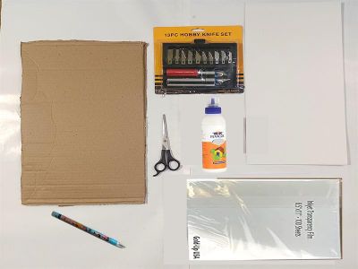

We need basic materials for cardboard bus at home.
The supplies could be divided into mechanical based and electrical based
The mechanical based supplies are
  1. Cardboard of A4 size --- https://www.amazon.com/Reskid-Chipboard-Sheets
  2. Hobby knife set --- https://www.amazon.com/Gardner
  3. Medium sized scissors --- https://www.amazon.com/Scotch
  4. 1 mm thickness white cardboard --- https://www.amazon.in/dp/B096T3ZZDQ
  5. OHP sheet --- https://www.amazon.com/Transparency
  6. strong glue --- https://www.amazon.com/Fevicol
  7. one ball point pen case
  8. empty refill of ball point pen

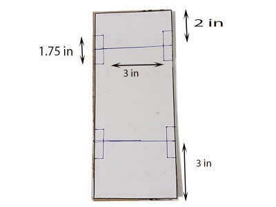

Step 3: Build the Chassis
Since the chassis is the fundamental part of all vehicles, whether motorized or non-motorized, building the chassis requires special care.
Mark a line 2 inches from the front end and 3 inches from the back end for the axle.
Take an old ballpoint pen case of about 6 inches and cut it into two halves of about 3 inches each.
Attach the axle to the chassis using strong glue.
Mark 0.875 inches from the axle line on both sides (totaling 1.75 inches) and remove the marked section for the wheel space.
Place the battery holder and switch on the chassis and mark their dimensions.
Remove the marked area and attach the holder and switch using glue.
