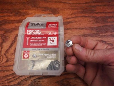

- 3/4" Lath screws (36 needed)

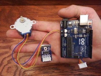

- 4 female to male jumper wires
- Stepper motor (28BYJ-48)
- Motor driver (ULN2003)

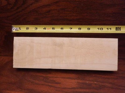

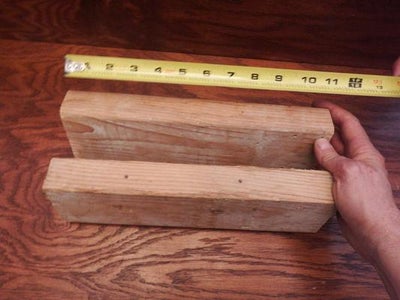

Cut two lengths of 2x4 lumber 12" long. The exact length is not critical, and scrap lumber works well so long as it is a standard 2x4.

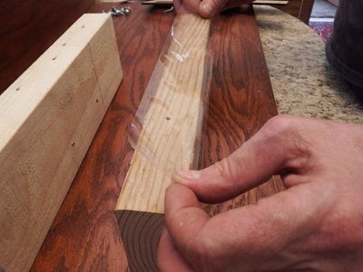

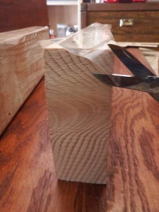

Place a piece of packing tape down one edge of each 2x4 (see image). This makes one edge of each piece slippery, to reduce friction.

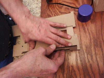

Using a laser cutter, cut the cardboard pieces. Patterns are supplied as LightBurn projects (.lbrn files) and DXF files (.dxf). If you don't use LightBurn, any laser cutting programs should be able to import DXF files.
The cardboard forms have two cut settings: "cut" and "half-cut". "Cut" slices all the way through the cardboard, and "half-cut" slices the top layer but does not cut all the way through.
Thus, a piece might have a "cut" edge along the perimeter, but one or more "half-cut" edges on the inside. Once the piece is cut, it is bent into shape, and the "half-cut" edges become a 90 degree hinge.

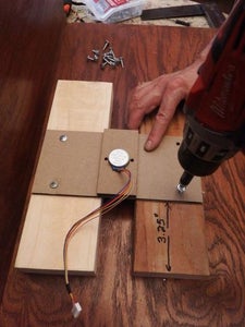

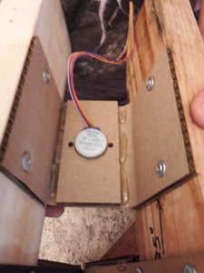

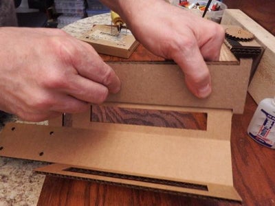

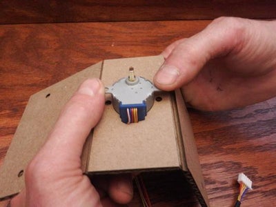

Step 3: Installing the Motor

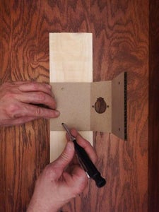

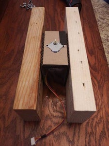

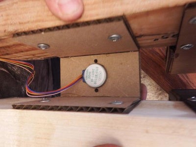

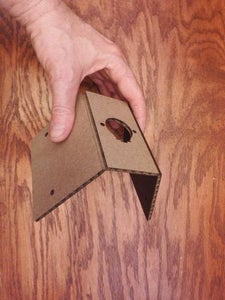

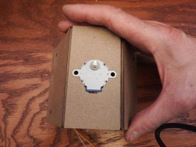

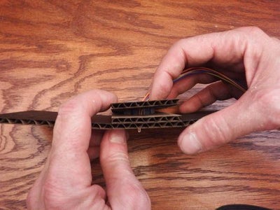

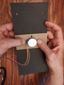

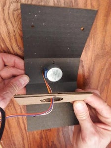

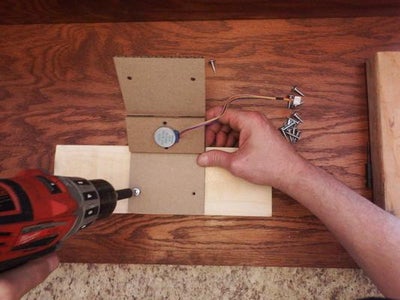

Push the stepper motor into the corresponding hole in the GearPlate so that the metal mounting holes are on top (see image). The motor should fit snugly.
Push two of the GearBack pieces onto the back side of the motor and glue in place to make a sturdy holder for the motor (see image).
Do not glue the two wings of the gear plate yet, these should bend freely (see image).

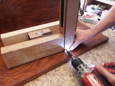

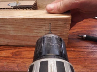

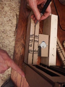

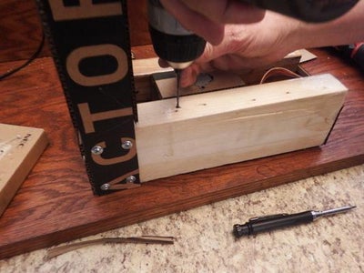

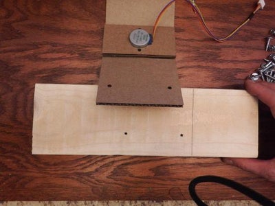

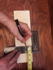

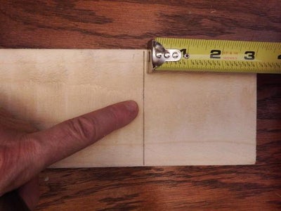

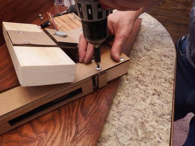

Using a pencil, mark a line across the 4" face of each 2x4, 3-1/4 inches from one end (see image). Note: This line is where the motor platform will go. In the videos we have moved this line an additional 2-3/4 inch for a total of 6 inches. Both the 3-1/4 inches and the 6 inches will work, we found the 6 inches to be easiest to work with should any calibration issues arise.

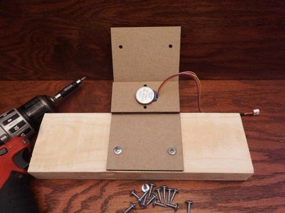

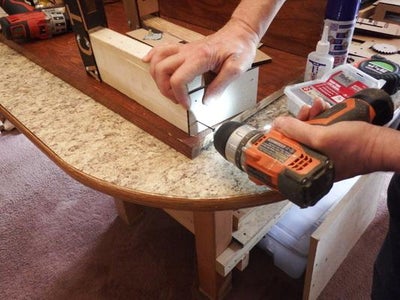

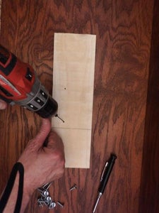

Place one wing of the GearPlate against one marked line, drill four pilot holes and install four lath screws as shown.
The gear plate is designed to match the height of a 2x4 and bring the motor to the correct height, so if you place the cardboard and lumber on a flat surface everything should line up.
Place the other wing of the GearPlate against the marked line on the other 2x4, drill and attach as before.
The GearPlate wings should still bend freely, with the lumber attached. They will be glued shut in a later step.
The gear plate should be behind the 3-1/4 inch line, and the top of the motor should be parallel to the taped edges, as shown.

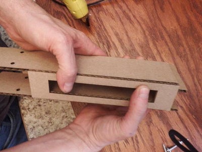

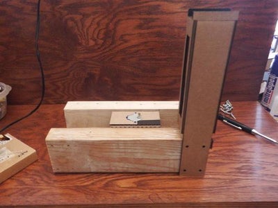

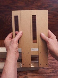

Step 4: Installing the Hopper

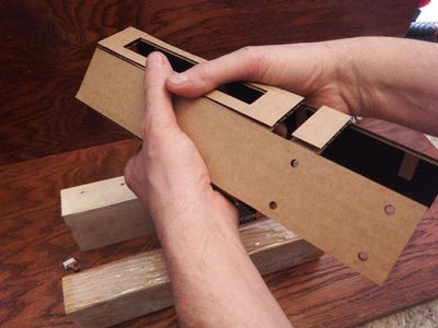

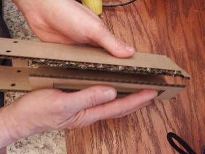

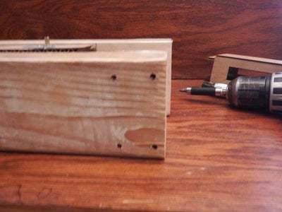

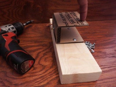

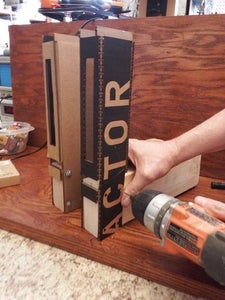

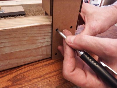

Take one Hopper cutout and bend it around the end of one 2x4 (see image). Mark and drill 8 pilot holes as shown, four on each side, then attach the hopper using 8 lath screws, four on each side.
Bend the fourth side of the hopper around to meet the first side and glue into place (see image).
The hopper is designed to fit the end of a standard 2x4, so if you place the board and cutout on a flat surface everything should line up.
Attach the 2nd hopper to the end of the second 2x4 board.
Insert two hopper shims into one hopper, one on each side, and glue into place (see image).
Glue two shims into the other hopper as well.

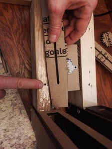

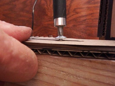

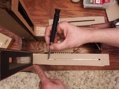

Step 5: Install the Pushers

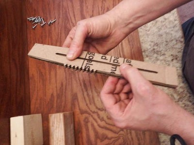

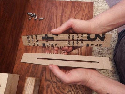

Make one thick pusher by gluing two pushers together.

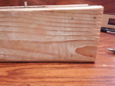

Place one pusher on the taped edge of the 2x4 with it's front end not quite in the hopper (see image), mark and drill a pilot hole at the forward end of the pusher slot.
Slide the pusher forward and into the hopper until the end reaches the end of the 2x4, then mark and drill a pilot hole at the rear end of the slot (see image).
Loosely screw the pusher to the 2x4 using two lath screws. Loosely!
Verify that the pusher slides easily forward and back, and is held in place by the lath screws.

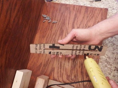

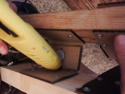

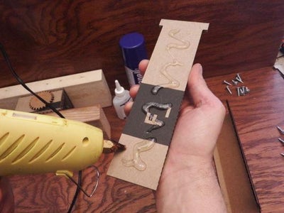

Step 6: Glue the GearPlate Wings
When the hoppers and pushers are installed, glue the GearPlate wings so that they don't bend.
Using hot glue, run a bead down the inside corner of the GearPlate to lock everything into place.

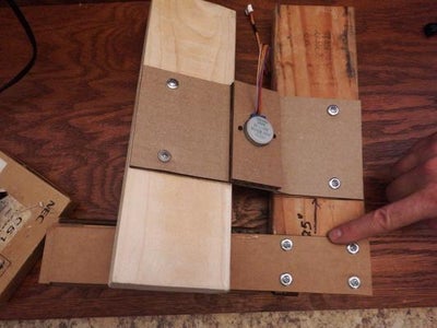

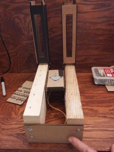

Step 7: Glue the EndPlates
Mark, drill, and attach the end plates across the ends of both 2x4 pieces using eight lath screws, four for each end plate.
The end plates should lock the the entire assembly together to make a sturdy system.

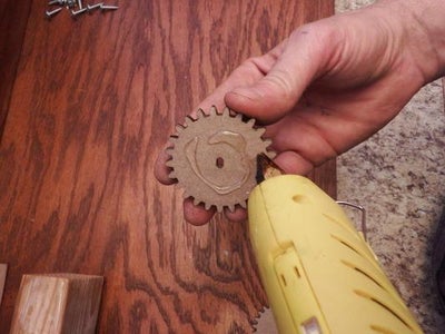

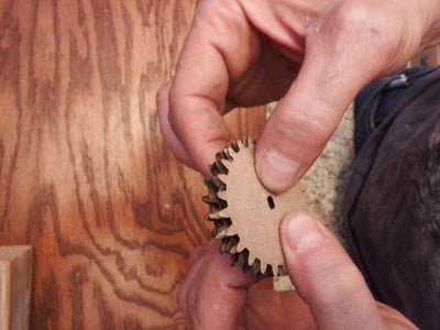

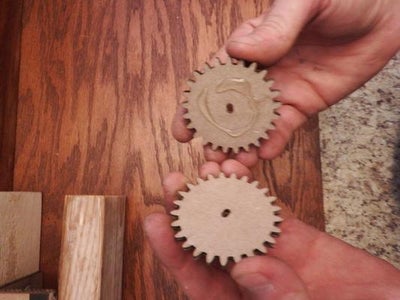

Glue two gears together to make one thick gear. Be certain the teeth line up before gluing.
Press the thick gear onto the motor shaft and cement in place using a liberal amount of hot glue.

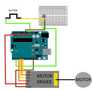

Connect the motor to the motor driver, then use the male to female jumper wires to connect the motor driver to your Arduino (I used an Uno.) Follow the connection diagram provided.
The pins are labeled on the motor driver, and if you're using an Arduino Uno, the pins are labeled on the board as well.
- Connect the 5V pin of the motor driver to the 5V pin of the Arduino.
- Connect the GND pin of the motor driver to any GND pin of the Arduino
- Connect IN1 to DIGITAL pin 4
- Connect IN2 to DIGITAL pin 5
- Connect IN3 to DIGITAL pin 6
- Connect IN4 to DIGITAL pin 7
If you are using a button, be sure to follow the provided wiring diagram:
- Connect one of the button leads to the 3.3V pin. Do not connect it to the 5V pin!
- Connect the other lead of the button to your breadboard.
- Connect your 1K Ohm resistor to the same row as the button lead, and put the other end of the resistor into a different row.
- Connect a male to male jumper from the row shared by the button lead and resistor to DIGITAL pin 2.
- Connect a male to male jumper from the other end of the resistor to any GND pin on the Arduino.

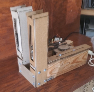

Step 11: Dispense the Candy
Fill each hopper with 20 bars of candy, making sure each bar lies flat inside the hopper, and power on the Arduino.
If you are using a momentary button to vend the candy, go ahead and press it!
Enjoy!
