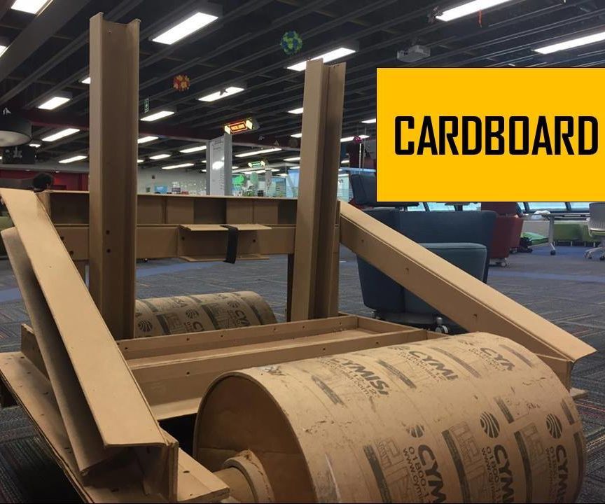

1. Now let’s get to work with the wheels. First you have to get a large resistant tube that can be cut in little cylinders. Cut as many as you need in order to get something like this:
2. Then, to fill in the empty spaces cut some cardboard and put it inside the empty spaces. Just like shown in the figure. Also, you have to cut 2 circles (more likely to the shape of a ring) of a size that fits with the cylinders (15 inches of diameter for the big circle, and 5 inches for the inner circle), remember that the diameter of the inner circle must be equal to the diameter of the cylinder at the center. Use some glue to stick it. You have to do four of this wheels.
3. Now, put a 5 inch tube inside the center of two of the four wheels we just built, and then put that inside a 15 inch tube. It must look like the one in the photo. Do the same with the other two wheels.
4. Until now, we have done the wheels and the structure bearers, then, the next step is to put all together
Step 4: LET’S PUT EVERYTHING TOGETHER!
1. Pick two 4-inches-diameter tubes and make this cut in each one of the ends of the two tubes. The cut must be big enough to fit inside it the X’s.
2. Take the two tubes and insert one in each wheel, remember we have two wheels that we made from the four little wheels we did at the beginning.
3. Now put the X’s inside the cuts we did before in order to make two parallel sides of the square drawn in the photo.
4. To reinforce the structure we have to do some perforations in the X’s we just sticked in order to add two extra bearers between each X bearer (the yellow ones in the picture).
5. To keep distance between each wheel we need to add another extra bearer between the axis. Remember that you have to do it in the two sides and you can use screws to hold the joints.
