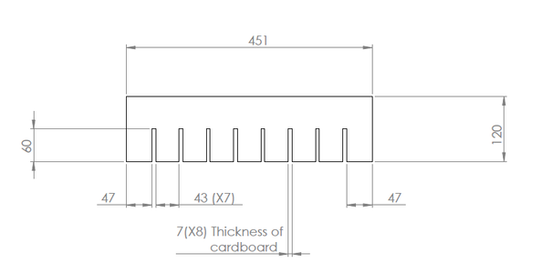

Step 2: Templet Horizontal Panels
Templet may be printed or drawn.
Print
Use the templet (cardboard chair horizontal plates) to print this, if you can draw it (thickness of the groves should be adapted to the thickness of the vertical panels that slide into these groves see the technical drawing.)
Draw
Make a drawing of the seat and backrest's horizontal panels using the dimensions shown in the image (the thickness of 7mm of the groves depends on the thickness of the cardboard, first measure the cardboard of the vertical panels that slide into these groves, and use this thickness.) Cut the drawing out, and use this to trace over the cardboard.
Step 3: Cutting Horizontal Panels
Use the paper templet of the chair to trace over the cardboard with a pencil and cut it out. It will be easier to cut the cardboard if you first cut the groves with a knife. The outline can then be carved out after that. Repeat this process 13 times to create all 14 horizontal panels.

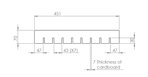

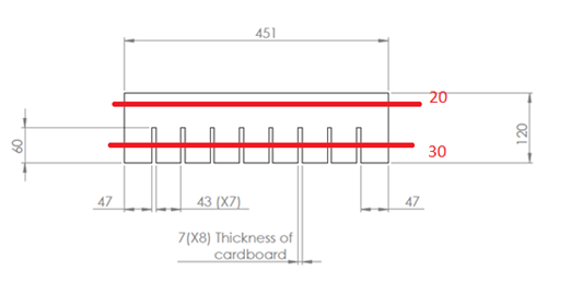

Step 4: Cutting Horizontal Panels
Draw out the first seating panel, this one is smaller than the other horizontal panels this one is 70 mm instead of 120 and the grove is 30 instead of 60. You do not need to draw a new template. Use the other templet and a ruler to draw this on the cardboard; the red lines in the second drawing show where the lines should be drawn. After that, you can cut one panel out.

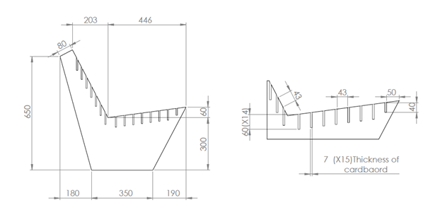

Step 5: Templet Vertical Panels
Print
Use the templet (cardboard vertical horizontal panels) to print this, if you can draw it (thickness of the groves should be adapted to the thickness of the horizontal panels that slide into these groves see the technical drawing.)
Draw
You can make the templet as well with A3 papers. Tape the papers together to create at least a big piece of paper with the sizes 720x 690 mm
Draw out the straight vertical panel, and use the measurements of the picture (the thickness of the groves depends on the thickness of the cardboard, first measure the cardboard of the horizontal panels that slide into these groves, and use this thickness.) Cut the drawing out, and use this to trace over the cardboard.
Step 6: Cutting Vertical Panels
Use the paper templet of the chair to trace over the cardboard with a pencil and cut it out. It will be easier to cut the cardboard if you first cut the groves with a knife. The outline can then be carved out after that. Repeat this process 7 times to create all 8 vertical panels.
Step 7: Assembly
Assemble the chair. Start with the outer two vertical panels. Then you can add 4 horizontal panels. After this add the other 6 vertical panels. Last but not least, insert the horizontal panels, then take a seat!
