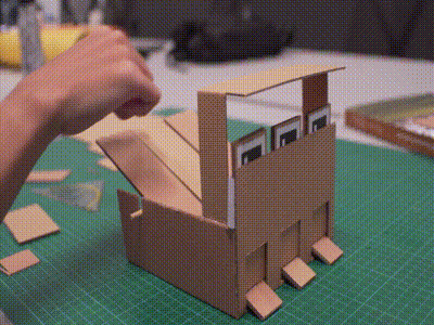

The concept is simple -- a see-saw with a longer handle towards the front and 3 vertical tabs with markers attached. Just like a normal see-saw, gravity will help push the longer side down, creating a responsive machine with 3 buttons. Each input, as long as you don’t hold the button, will be obscured quickly so as to increase reliability.
Here I will break down some important problem-solving that I went through in order to come up with a final design and I will provide ways of improving reliability and reducing the error rate.
Step 2: Pivot Sheath
- Roll papers and stick them nearer to the back (pressing area) of the paddle, roughly 5-7cm away from the end
- This secures the paddle when pivoting and keep the pivoting consistent
Step 3: Tab Holder
- As the vertical tabs are moving up and down, a lot of rotational momentum is involved and it is easy for the tab to move away, fall off, or get stuck
- You could also glue a small separator so that the 3 tabs are fully separated
Step 4: Mouse Hole
- If the paddle extends to the bottom of the machine without the mouse hole, it will encounter a lot of friction as it tries to push against the wall
- Once the pivot sheath is secured, the paddle can’t move forward and back, hence the mouse hole provides ample space for the lifting movement of the paddle
- Creates an upper bound for the maximum paddle lifting height
Step 5: Paddle Notch
- This allows for secure movement at the front of the machine (the contact area)
- Also ensures that it doesn’t leave the marker tabs behind by extending the front into the mouse hole to maximize the contact area
Step 6: Roof
- After trying the machine to play, the speed and power involved when quickly pressing inputs have been launching the marker tabs to be stuck or even ejected out of the machine
- The roof provides safety and ensures the marker tabs remain safely in-bound
- Helps with detection since the marker tabs will get stopped instead of moving too quickly or too high
