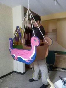

Cut the 2 panels (110x45 cm) into the desired shape. In my case, it was a dragon.
Step 3:

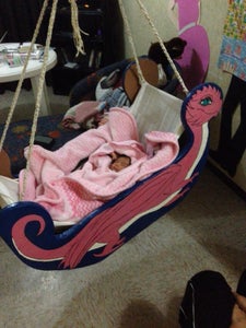

Once dry, glue these rectangles as shown in the picture, using the large rectangles as the sides and the small ones for the cradle floor. Create a 30-degree inclination with the 30 cm panels and let them dry with a counterweight.
Step 4:
Start gluing strips of newspaper to cover the entire piece and let it dry.
Step 5:
Paint the cradle with the colors and patterns of your desired design.
Step 6:
Make two holes and place the wooden sticks at the front and back.
Step 7:
Attach the rope to the wooden sticks for hanging.
Step 8:
Place blankets or quilts inside the cradle to cushion it and prevent the baby from turning face down.
