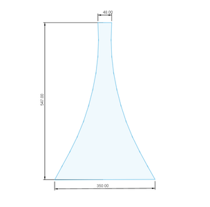

To design my horn, I used Fusion360 to create a loft shape from 3 hexagon.

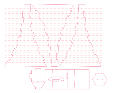

I then unrolled one of the sides of the lofted shapes to give me a flat pattern, I also added tabs so that when I assemble the horn these tabs will lock into each other.
I have attached a PDF with my patterns that you can use to either print and then hand cut or laser cut your cardboard!
I have now also included Letter sized tile print too!
To achieve a wrinkle-free smooth curve in the card board I scored the cardboard at every flute.
You will need to cut through the top and middle layer of the cardboard, this allows the cardboard to become flexible.

Now that you have cut all the cardboard for the horn and dock, score the dashed lines and assemble as shown in the images below.
Use tape to complete the dock.
Next assemble the horn by interlocking each 'petal' of your horn as shown ensuring that each tab is secured.
