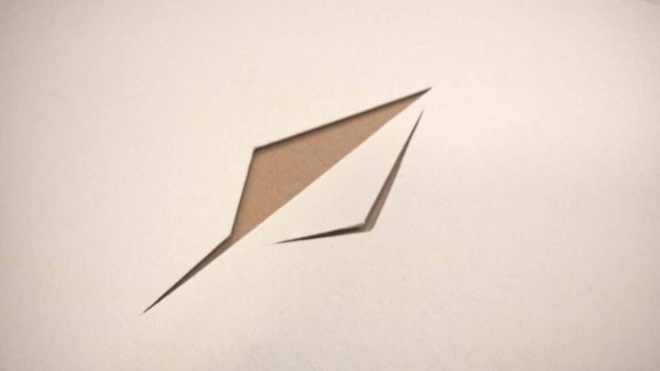

First, you have to draw the plans on the cardboard, don't forget that you will have four legs ;)
You can make your own design for the top of the table from the white paper, we made a leaf (admit it, it's very cool)
