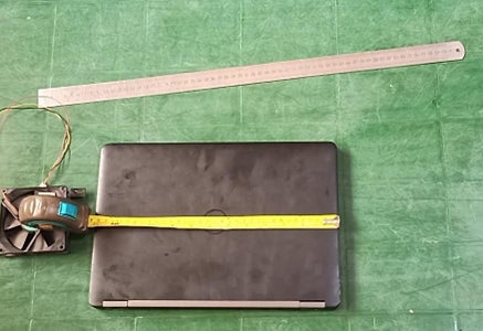

Step 1: Get Your Laptop Dimensions
The first step is to get your laptop dimensions, particularly the width and the length as shown in figure 1a. Also, measure the thickness of the laptop. The thickness will also be relevant at a later point.
