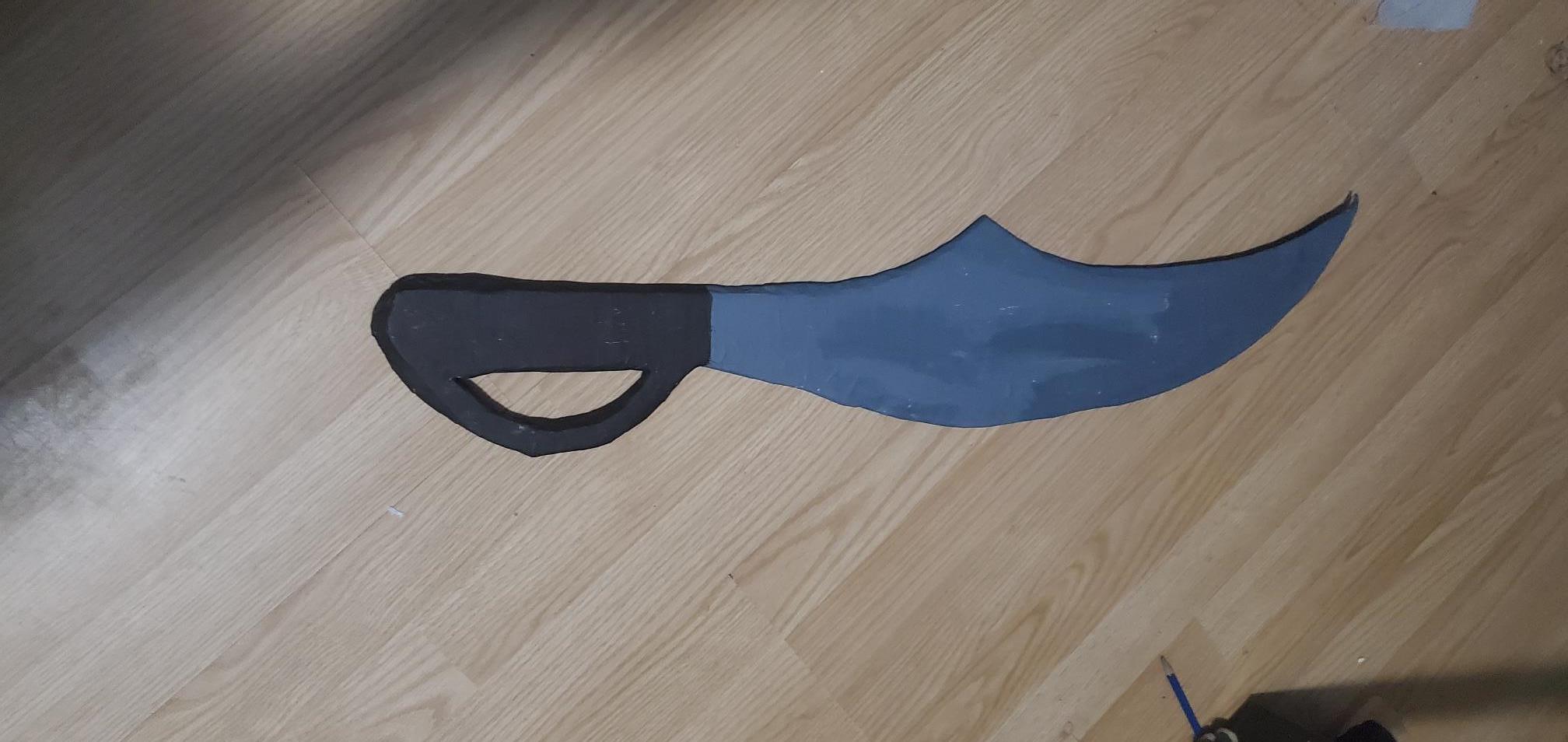

Step 7: Paint the Handle
start marking where your handle starts and finishes, use that as a guideline and paint the whole handle. I used a mixture of brown and black until I found the shade I liked (roughly three parts brown and one part black)
Step 8: Paint the Blade
mix white and black to make an even gray tone, and paint your blade and let it dry. use as many coats as you need for an even colour. when the paint fully dries use silver paint to the gray area to make it shine and add a metallic look. if you experience cracking in the paint, dot extra paint in those areas, and make sure each crack gets filled
