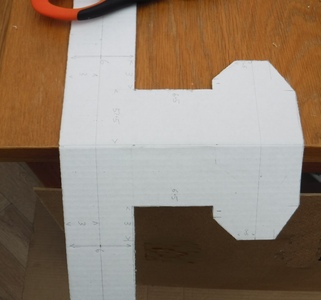

Orientate the piece of card (370 x 230 mm), with the long edge horizontally.
With the pencil and ruler, proceed to mark the card as per the diagram.
Once the card has been marked, proceed to cut the card with a sharp blade using the ruler as a guide
Folds are marked with dotted lines
Holes are marked with a cross.

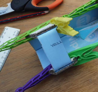

Once the pattern for the car has been cut out folds are required to give it shape and strength.
Align the centre line on the card with the edge of a table or box and carefully apply pressure close to the line on the card overhanging the edge of the table/box, pushing the card down to form an angle of ~60 degrees.
Proceed to bend the two short tabs inwards to an angle of ~90 degrees.
The long tabs require three bends, one down at 90 degrees, one up at 180 degrees and one down at 90 degrees

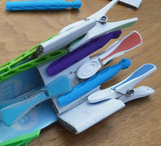

Apply glue to three surfaces on both tab sections and stick together using clothes pegs or other suitable clamps to hold the surfaces together until they have dried.
