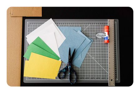

Step 1: Materials
  • Cardboard Sheet (18”x12”)
  • Cardboard Box (6”x6”x6”)
  • Colored Paper
  • Ruler
  • Marker
  • Cutter or Scissors
  • Glue Stick
  • Cutting Pad

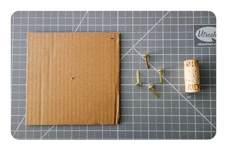

  • Cork
  • Round Head Fasteners
  • color_code_map.pdf Printable or Sheet of Paper

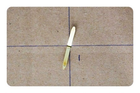

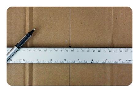

  • Measure to mark center of all the sides of the cardboard box. (You do not need to do this for the top and bottom folds).
  • Make a hole in the center of each of the sides. Use the tip of a pencil to make the hole. Make sure that a round head fastener can pass through the hole.

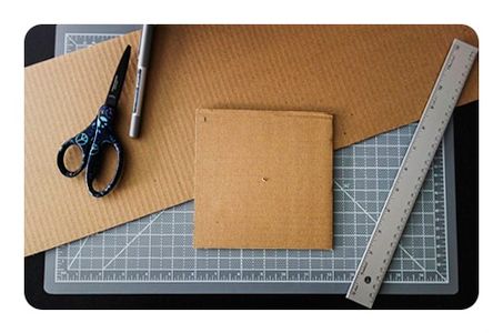

  • On the cardboard sheet, measure and cut out six squares (6”x6”).

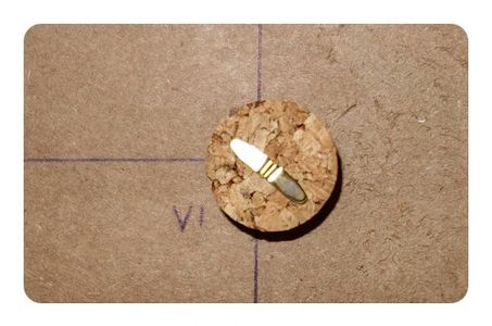

  • Cut two slices of the cork, which are each 0.5” thick. Place the end of a round head fastener and push it through the cork until it passes the other side. Remove the round head fastener. Repeat for the other cork slice.

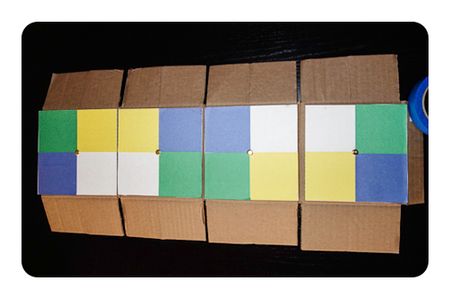

Step 4: Building the Puzzle
  • Using the map as a reference, glue the colors sheets onto the corresponding cardboard square.
  • Make a hole in the center of each cardboard square. Use the tip of a pencil to make the hole. Make sure that a round head fastener can pass through the hole.

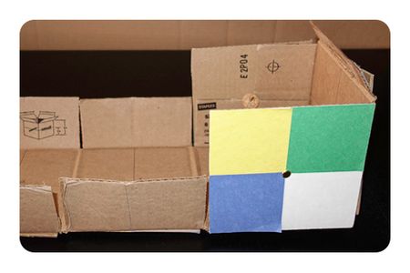

  • Place the numbered cardboard square against the matching numbered box side. Place the round head fastener in the holes and secure it to the inside of the box. Repeat this step for the remaining squares and box sides.
  • Place the round head fastener in the hole of the top cardboard square. Push the round head fastener through the sliced cork. Leave a gap between the cardboard square and the cork and then fold the fastener over the cork. Repeat this step for the bottom square.
  • The cardboard box is finally ready to be folded. Start at an end of the box and fold inwards all the folds. Then fold the cardboard box side up and fold over the folds with the next folds. Repeat these steps until you reach the last pair of folds.
  • Place the top and bottom squares between the folds of the box.
NOTE: Make sure the numbered top and bottom squares correspond to the numbered top and bottom folds. If they don’t the puzzle can never be solved (and that’s evil).
  • Wedge the cork between the folds on the inside of the box to secure the square. Repeat step for the other square.
  • Close the gap to secure the top and bottom squares.

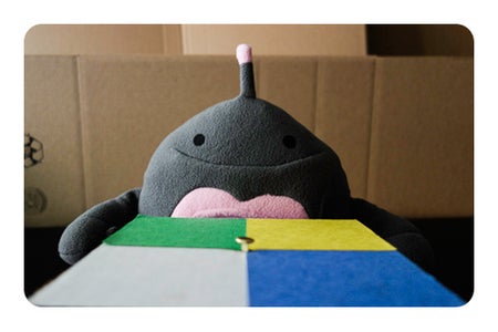

Step 5: Play

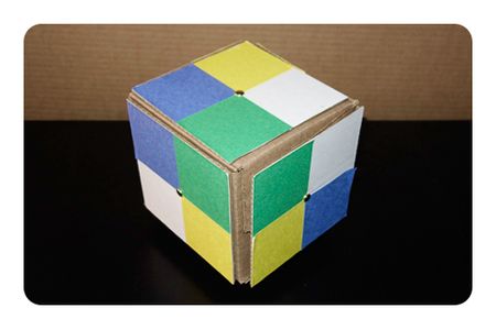

  • Rotate each side in any direction you choose. Your puzzle is set. Enjoy!
