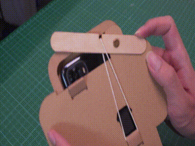

Step 3: Assemble Back Plate
Place a rubber band within this cardboard tab to-be (shown in the photos). Fold it outwards along the score lines and tuck the tab into the slot, securing the rubber band in place. Fold the other tab along the score lines and tuck that tab into the slot. This tab is meant to hold the “shutter” in place, in front of your phone’s camera lens.
Attach the tongue depressor to the outside of the back plate using a paper fastener, ensuring the tongue depressor can rotate freely. Open the fastener on the other side to hold the pieces together.
Hook the rubber band onto the notch in the tongue depressor. You’ll now see that the tongue depressor will be pulled towards the bottom of the back panel, but will be stopped by the cardboard tab. The shorter, exposed end of the tongue depressor can now be pressed to move the “shutter”, hiding or revealing your phone’s camera lens when needed. This will be the outside of the phone case.
The shutter mechanism is now done!

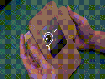

Step 6: Add Front Plate
Glue the front plate to the velcro on the phone case and leave to dry. You’ll now have a phone case with a removable front plate and a manual shutter on the rear!

Step 8: Begin Scanning!
Navigate to this web app on your phone: https://interactive-materials.github.io/scanner/, lay your phone into the case and attach the front plate using the velcro, and you’re ready to use the app! Press the shutter to block or expose your phone’s camera over a barcode, and watch it react and display any pre-set associations you have made.
