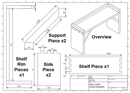

Whenever a project has many specifically-sized parts that need to be made, I always find it helpful to have a reference drawing while measuring and cutting. Luckily, Fusion has a really straightforward way of creating technical diagrams with the Drawing tool. I brought in models of each of the cardboard pieces that would need to be cut out, and added dimensions so I could reference them while I was cutting. I printed it out and kept it next to me during the following steps so I could make sure I was on the right track.
To make the diagram, I opened the Drawing tool in Fusion and used the "Base View" button to bring in all of the pieces. I arranged them evenly on the sheet and used the dimension tool to note the side lengths of each part. I numbered them so I would know how many of each I needed, and then printed out my diagram to use later.
Step 3: Reference Drawing for Download
Feel free to start here! Download the template, print it out, and move on to Step 4.
