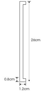

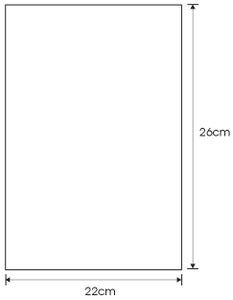

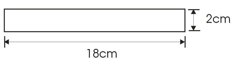

Step 1: Materials Needed:
- Scraps of cardboard in sizes:
1 for an A4 (21.0 x 29.5 cm) 1 (26 x 22 cm) and 2 (26 x 1.2 cm) and 1 (18x2 cm)

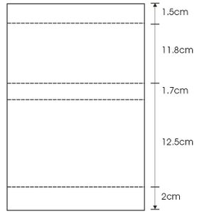

Cut the sheets of cardboard as measured.
Note: the meaning of "stripes" of the cardboard should be horizontal. following the design of the court.
OBs 2.: On the sheet where you have the various measures is not to cut completely. Straight cut two layers. The cardboard I used three layers (top middle and bottom), interspersed by the ripples. It'll be like a concertina movement, opening and closing.
The layer should be cut to the outside. See figure.
The sheet of cardboard to keep the party split down 2cm and 1.5 cm up. At the top, put the stick of barbecue inside the cardboard as a guide.
Paste the side straps and attach the severed strip of cardboard, taking care to put the barbecue skewer so as not to peel off the strips.
glue the bottom and slide the top to make a 90 degree angle. That done, use the strip of cardboard 18cm x 2cm as a stop, pinning her.
