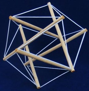

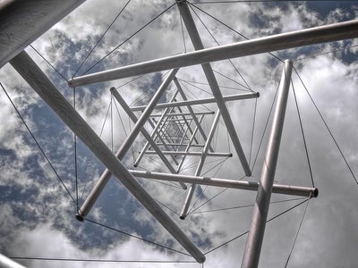

Tensegrity is a property of structures in which all members are isolated, yet they experience compressive forces due to them being connected through tensive elements such as cables, resulting in a stable structure. Some examples of tensegrity structures are included, most notably, the human spine, which was quite surprising to me.

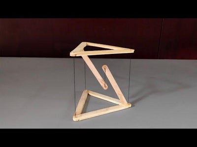

We chose to make a tensegrity structure featuring a triangular base and two members that meet in the center. We also figured that using a single sheet of cardboard wouldn't provide adequate strength to withstand the tension forces, so we decided to use multiple layers of cardboard.

We had to figure out the best way to manufacture the structure as we went along. We started by gluing some of the layers together. The toothpicks would be used to fasten the fishing line to the cardboard (sort of like the T-shaped Garvey fasteners you find on clothes in a store). We wrapped the fishing line around the toothpicks and poked holes in the cardboard to feed the line through.
We then hot-glued the center member to the bottom portion, putting fishing line through it as well.
We assembled the other half, leaving the top exposed so that we could tension and hot-glue the fishing line from the bottom portion. We also found that tensioning the central member before the 3 corners made the process a lot easier.
Step 5: Final Product
After some adjusting to the tensioning, we hot-glued everything together and it worked! As you can see, it can hold small items like a computer mouse, but we haven't tested it enough to see how much weight it can hold (which I assume isn't a lot).
