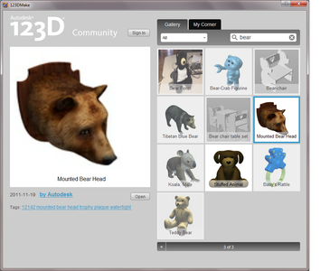

The process is simple; create a free 123D acount, open the 123D Make online app, select a CAD model from the huge online community, slice the model, select the slicing direction, and choose the sheet size you want your slices cut out on. If you download the desktop app, you can also change the size of the model and create other effects such as hollowing out the model(as seen in the rhinoceros during assembly). The files are easy to export into Corel Draw or other laser cutting compatible design softwares. Cut the models out with the laser cutter(or if you are not able to access a laser cutter, with a scroll saw or an exacto knife) and prepare for assembly.
