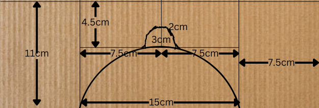

Cut out pieces of cardboard as below. The dimensions may vary according to the phone you are using. In my case, I am using IPhone 12 Pro Max so the dimensions of the phone are 8.5cm x 16cm x 0.5cm.
So the dimensions of the VR headset for me are 7.5cm x 15cm x 11cm.
Adjusting the height of headset to be 1cm less than length of phone, make length to be 1cm less than width of phone reducing it to 15cm(0.5cm from both sides), the width of box is 11cm which depends on the type of lenses you will choose. An image representation of the all the stuff is in the image above.

Step 3: Creating Gap for Face
Now this step is for cutting away parts to fit the face in.
By just marking the center of the lens placement line which is 7.5cm from both lines on the side. Now you can either draw a semi circle or a parabolic shape touching the bottom sides and the point marked above.
I did mine by hands because a perfect circle(drawn by compass) may mess up things later So an unstable hand is suggested to give this part to someone else with a stable hand.
Step 4: Making the Upper Part
Take a cardboard piece and draw the bottom three faces of the lower part we just made. You can instead use the image above. Remember the dimensions should be same as the lower part.
Step 5: Creating Gap for Nose
Now this step is for the lower part only.
Again this may vary and my data given here should work for most people unless you identify as pinocchio.
So start by marking a point 2cm above the center point used for making the gap for face and two more 1.5cm away from that point in both direction of the point on the lens placement line. The horizontal line should be 3cm.

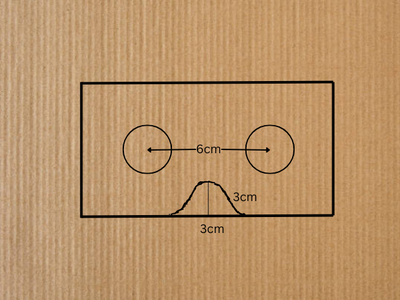

Step 6: The Lens Board
Now cut out a 15cm x 7.5cm cardboard and draw a line along the 15cm side and mark two points on equal distance from the sides. The distance between them should be your interpupillary distance (distance between pupils). In my case it is 6cm. Now from those two points draw a circle of diameter equal to the diameter of your lenses, here it is 2.5cm.
For inserting the lenses you can either clear out the bits of cardboard between the layers and try to put it right in. It can be hard and needs higher precision and gives a clean look.
But if you are not too much into looks or your cardboard is too thin to fit the lenses you can make another lens board and place the lenses between them sticking them together with some glue or anything you can find sticky enough.
