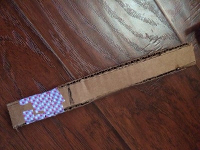

Step 5: Step 2: Seesaw Mech.

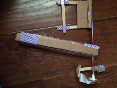

Next you want to make the seesaw. take a popsicle stick and cut it into 5 pieces, they don't have to be the same size. glue those pieces to one end of a new popsicle stick, stacking them on top of each other. Then take a strip of flimsy cardboard and take your skewer, put it on the middle of the strip of cardboard, fold the cardboard over the skewer and turn the skewer in the little hole you made with the cardboard. Glue this to your stack of popsicle pieces. stick your skewer in the hole again to make sure it fits and then remove the skewer. On the side of the popsicle stick without the hole for the skewer, place a piece of popsicle stick stand up. you want to set that aside

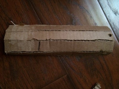

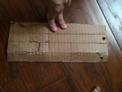

Step 6: Step 3: Push and Pull Button

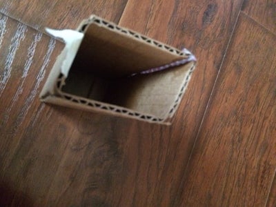

You will now make your push and pull button. take a piece of cardboard that is roughly 25cm by 10cm. cut as shown in picture (make sure hole are just big enough for the skewer to fit through).The lines are cut through halfway to make it easier to fold. fold along the cut lines to form a square. glue or tape it together.

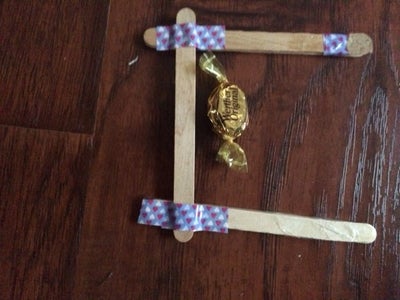

Step 7: Step 4: Candy Catcher Thing

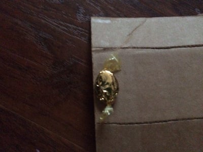

now you are going to make the thing that catches the candy and pushes it into the hole, on the ramp and out to where the candy comes out. Take 3 popsicles sticks and position them so that they form 3/4 of a square. place your candy in-between the popsicle sticks to make sure that your hole is big enough. where your candy ends, place a piece of cardboard so that your customer gets only one candy and not two. glue your pieces together and cut off any excess popsicle stick. set this aside.

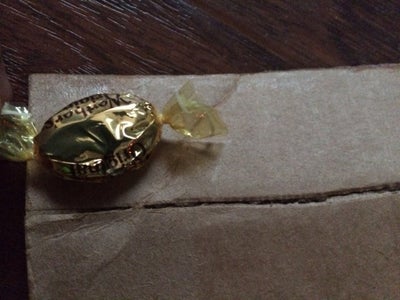

Step 8: Step 5: Candy Holder
Take a piece of cardboard and place your candy on it. mark off where the candy ends. Sideways then long ways.
Partly cut and fold in to a rectangle like you did with the button. glue it together.

Place the skewer through the seesaw, then through the button and at the end, glue it to the candy holder thing. At the end, where the seesaw is, glue the skewer to a piece of cardboard the height of your button. This will prevent the stuff from falling off the skewer.
