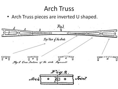

Step 1: Arch Pieces
The Arch supports the flooring, and all of the vertical and horizontal pieces are made of cardboard.
Step 2: Drawing the Arch Pieces
Using the patent drawing by Whipple as a guide, a scaled model for a 80 foot bridge was drawn.
These pieces were drawn onto cardboard:
(2) 11.25 x 2 inch rectangles (a)
(4) 10.75 x 3.4 inch rectangles (b)
(4) 8.75 x 4.5 inch rectangles (c)
(4) 11.5 x 6 inch rectangles (d)
A lot of 1.5 inch wide cardboard for the U parts of the arch

Step 3: Making the Sides
The Arch has interlocking sides, this is what they look like.
After making the first side of the bridge without them, and seeing how unstable it looked, I made the second side like Whipple designed it. How should I know about mechanical engineering; I'm an electrical engineer.
