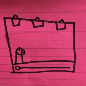

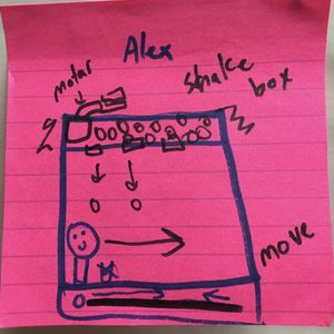

Plan: Have participants think about an idea they would like to build and draw an initial sketch. You can use the project sheet (see downloadable: Our Design Process PDF), or just keep the sketches and add them to the Our Design Process sheet later. The sheet is designed so participants can document their evolving ideas, and to provide an entry point for discussing the design process (see Resources).
Participants’ ideas may change quite a bit, especially at the beginning, so if you are using the sheet, participants may need to start a new sheet if they switch project ideas. In a future session, when the projects start to be at a playable stage, have students play-test their creations and summarize the results on these sheets (see Step 7 ).

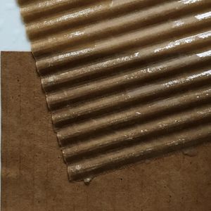

To set up before this activity, take a small piece of corrugated cardboard (3x4” or so), one per participant, and soak it in a container of water for about 10 minutes, or long enough for it to be easily separated into layers. Explain that, since we are going to be working with cardboard, it is a good idea to spend some time investigating it -- it always helps to know about the materials you are building with. Have students, “dissect” the cardboard, and see what they can learn about it. One of the things you can see is that cardboard is essentially made up of pieces of thick paper.
How can something made from paper be strong enough to use in boxes or other constructions?

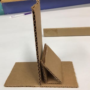

Give participants a challenge: give each participant two index card-sized pieces of cardboard, and challenge them to join them at right angles. Try to make a joint that does not wiggle too much.
- Are the two pieces securely joined or wiggly?
- How strong is the joint? What techniques did you use?
- Can you make it stronger?
See the Resources section for examples of various ways to join pieces of cardboard together.

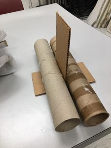

You can get a lot of ideas by looking at cardboard packaging. There are some very clever designs. By using only cardboard -- no staples or other materials -- designers can make the packaging more fully recyclable. Try to collect some interesting examples.
Here are some challenges to try with just cardboard -- no tape, or other fasteners this time:
- Try to join two pieces of cardboard together. Look at slots, tabs, and other cardboard designs.
- Make a brick shape that will not squish easily.
- Make a cardboard platform you can stand on.
- Make a box (with a lid for an extra challenge).

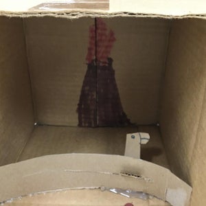

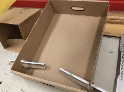

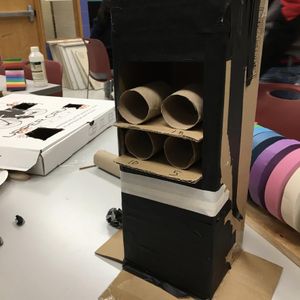

Step 6: Make It Move Challenge
Think about all the moving parts that would be useful in the games you are planning. Do they fall into the categories below? Feel free to add more categories. You can also do a scavenger hunt: try to find examples of moving mechanisms from around your house or room.
Pick one of these mechanisms and make a cardboard version of it -- for this challenge, it is helpful to use tape and other materials.
Hinges -- look at doors, box lids, or books. A hinge is one sort of flexible connection between two pieces of material. You can also find other types of joints, such as ball joints, that allow different sorts of movement.
Tape can be used to make good hinges between pieces of cardboard, or you can cut through one face layer of the cardboard, letting the other layers act as a hinge.
Sliders -- look for drawers, windows, or sliding box lids. A game might use a slider to keep track of the score, to push a ball, or make a window that opens.
Sliders can have one piece of cardboard that slides and other pieces that form a channel for it to slide in. You can also make a slot in a piece of cardboard and use a paper fastener to attach a second piece of cardboard that slides along the slot.
Axle or pivot -- An axle or pivot lets something turn: a wheel, or a spinner, or a pinball flipper. The axle might be attached to a wheel (so turning the axle turns the wheel), or the wheel might turn freely.
Paper fasteners make good axles since you can easily poke them through a cardboard wheel, then through a cardboard base.

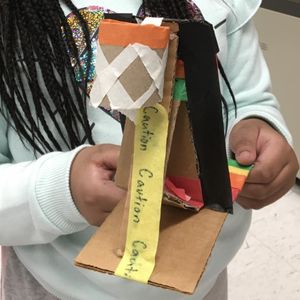

Step 7: Playtest
After participants have made a working version of their game (not finished, just workable), they should playtest their game with several other people. Ideally, participants can playtest their games with each other. If you're working remotely, participants can have a sibling or parent try it out.
Use the playtest to get ideas for improving the design. For example, participants may find it is too hard for a player to reach the goal in a maze game, and they will want to make it easier. Or perhaps they find they need to increase the challenge. Maybe they find a part that needs to be made stronger, or easier to move.
When participants have had a chance to playtest their creation, have them document what they found out on the Our Design Process sheet and think about how to improve their design. Don’t wait too long to do the play tests -- you want to leave plenty of time for revisions. Ideally, the projects should evolve through a couple of rounds of playtesting and improvements.
The idea of designing, testing, and revising your design (based on the testing) is critical to the design/engineering process (see Resources). This is also a good point in the workshop at which to discuss the design/engineering process explicitly.
Step 8: Final Presentation
At the end of the workshop, hold your in-person or virtual showcase where students can let others try their game. Display the Design Process Sheet along with participants' creations, and have participants talk about their process and how they improved their game along the way.
