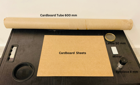

Materials Needed:
  • Cardboard tubes (650 mm approx.)
  • flat piece of cardboard
  • Cardboard sheets
  • Telescope eyepiece
  • 50 mm lens
  • A small mirror (for the diagonal)
  • Hot glue gun and glue sticks
