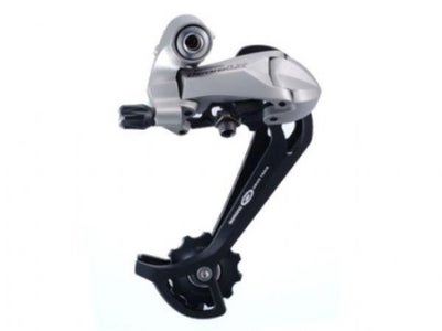

- 04 gears of a bicycle rear derailleur gears (screw, inner cylinder and the two caps, each);

After turning the servo to continuous rotation, solder two wires directly contacts the engine, by-passing the electronic circuit. I used the wire itself the servo, taking care to leave a tip of three wires which were originally linked to later be able to use again as a servo. That done, simply reassemble the servo. A good tutorial on how to put the servo continuous rotation:
http:// http://arduinianos.blogspot.com/
Combine the two crosses as figure using screws or gluing tight.
The crosses were selected because they have a center that fits mayor, allowing an optimal alignment between the servant and gear.

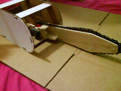

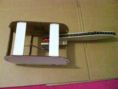

The saw was made with a piece of old bike chain (about 75 cm) but would be very heavy. At first I put the chain on top of the strip and tried to find the best position for the gears. After that, I made the holes with a drill, mounted and fixed gears. I put the chain and marked with a pen so that when she was stretched, it should come as much as possible around the body of the strip. After these adjustments, I made a template to facilitate.
I made a servant to put the amount and stuck it into the body of the mountain by the same method of trial and error. It was found that the chain was still a little loose. Hence, I used two screws to the metal cylinder to stretch the chain a little. the result was very good.
Note: This metal cylinder must be supported only by the screw, that is, it must run to pass the stream.

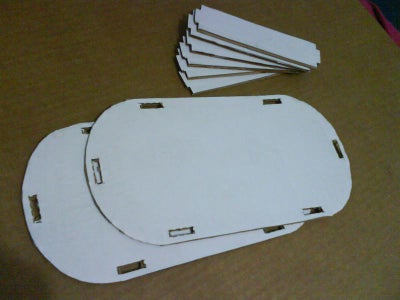

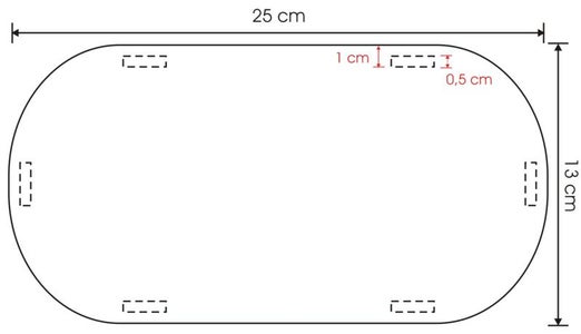

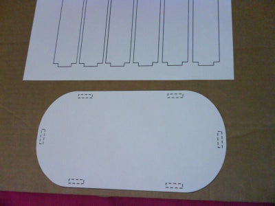

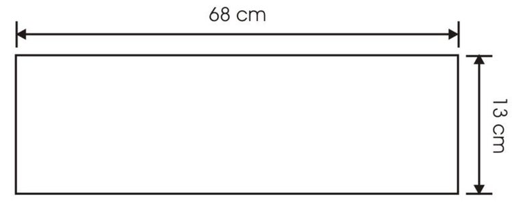

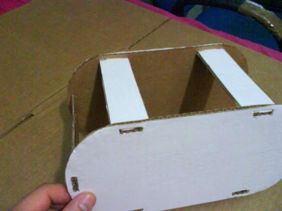

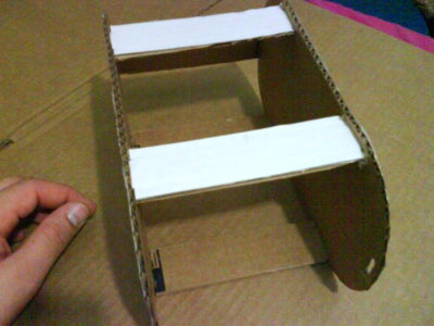

The body of the saw was made of cardboard.
materials:
- Cardboard
* Note: I used a 0.5 cm thick. This determined the distance between the edge of the body and the workpiece support.
- Hot glue;

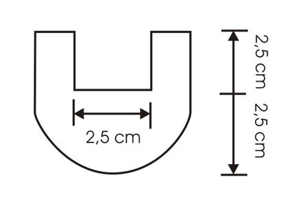

Print layout and paste the picture on the cardboard . Cut and assemble.
