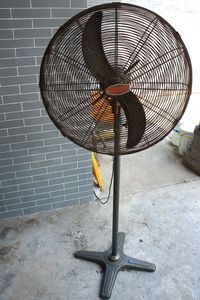

  3. A 2-blade prototype. The idea came from the blade designs of some industrial fans. Although somewhat noisy, it was surprisingly capable of creating strong winds. Not too bad for something crafted from the side of a pizza box.

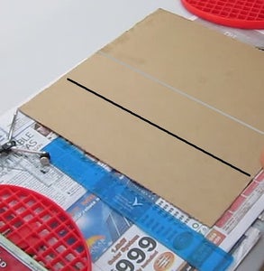

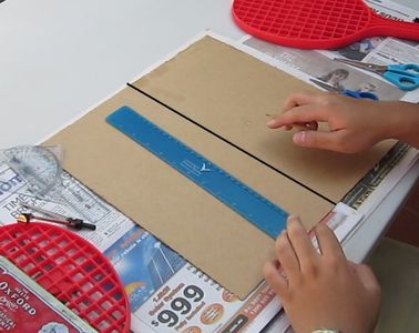

Step 3: Cut Out a Blank Square Piece of Cardboard to Work On
If you've got a pizza box, dissect it. Cut out the top bit (which is usually not oily). Else, just cut a square piece of cardboard out of a box, roughly the size of your fan.

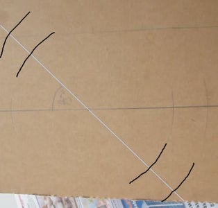

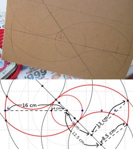

Step 4: Draw the Design

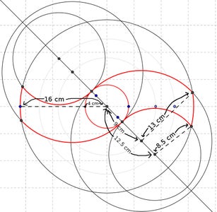

The following instructions are for if you want to make my 2-bladed fan design. I have provided a schematic of my 2-blade design to make it easier to understand.
  1. Divide the square piece of cardboard into 2 halves. You'll only need 1 half to craft my 2-blade design.

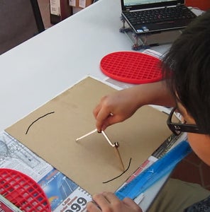

  2. On 1 of the halves, find a centre point and draw 2 wide arcs opposite each other, with radius 16 cm.
  3. Draw a straight line through the centre and the 2 arcs, using the ruler. This line should cross the 2 opposite arcs. Afterwards, draw another line at a 45 degree angle to the straight line.
  4. On the angled line, draw 2 arcs on each side with radius 9 cm and 12.5 cm each.
  5. Draw a circle with radius 4 cm at the centre. This will become the fan blade's hub.
  6. Draw an arc with its centre at the outermost intersection, starting at the closer side of the centre circle.
  7. Next, draw another arc with its centre at the other intersection, starting at the far side of the centre circle.
  8. Repeat steps 6-7 on the other side. Afterwards, the outline of the collection of circles and arcs you've just drawn should look just like the schematic.

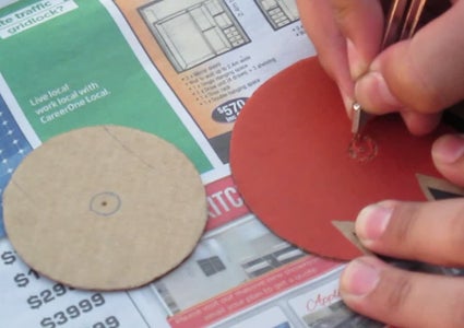

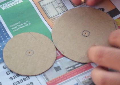

Step 6: Cut Out the Circular Blade 'hub' Parts
Draw 2 circles on the bits of the leftover cardboard from the previous step, then cut them out.

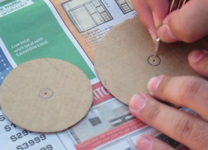

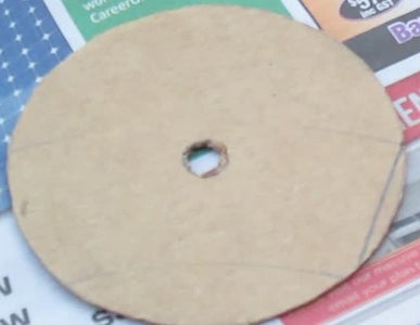

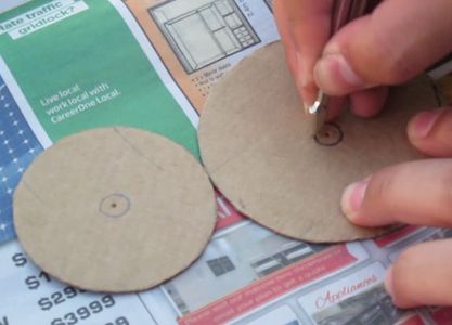

Step 7: Puncture Holes and Cut Slots
Now we need to find a way to puncture the holes in the blade, so that it can slip on the motor shaft easily.
Here's the method I used:
  1. Measure the radius of the motor shaft.
  2. Using this measurement, draw small circles in the centre of the 2 circular pieces and the main blade.
  3. Using the sharp needle on your drawing compass, poke through one of the circular pieces on various spots in the mini circle you just drew.
  4. Tear through the holes using the sharp needle.
  5. Flip over and repeat steps 3-4.
  6. Push out the unwanted little circle, and the hole is formed!
  7. Repeat steps 3-6 for the other circular piece and the main fan blade.
  8. You might want to fit it on the motor shaft just to check if it fits nicely.
  9. To ensure the blade engages with the pin on the motor shaft, cut 2 slots opposite each other in the larger circular piece, as well as the main fan blade.

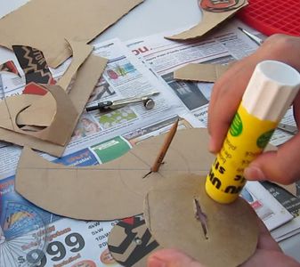

Step 8: Glue Them Together
Using the glue stick, glue the 2 circular pieces to the main fan blade, ensuring that the slots on the blade and the larger circle match up.
