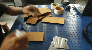

Download above files and take print out on a4 paper.
After printing design on a4 papers cut using scissor
Use Cuts to trace on Cardboard using pencil or you can stick cuts on cardboard sheet
Once you done with it use blade cutter and cut cardboard carefully
cut all cardboard design on cardboard
then using same Idea cut out all mirror design on mirror paper (can use any reflective foil)
Be careful with cutting and go slow
( Here I have used laser cutter to cut out parts and also tried with hand cut since most will not have laser-cutter)

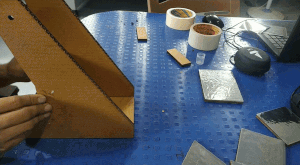

Step 3: Stick All Pieces and Assemble

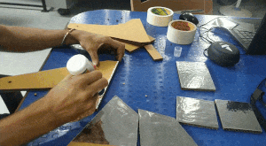

So Before you glue all part make confirmation about position of all parts. Here maybe you need to modify some part to fit it properly as you go you will know.
Use normal glue since it is papers you need to hold things for long until it get stick with each other well which is slow process. Else if you don't have patient can use instant drying glue but then you have to be fast and accurate

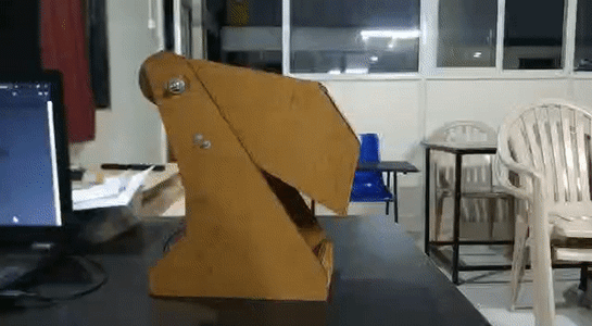

Once you complete sticking pieces you will have two parts - head and body. head is part with reflective paper where our led will come and body is big L-shape part where to will put your limit switch and battery.
connect head part with body using 6mm diameter bolts, washers and lock nuts.
Here I used lock nut to prevent nut from falling off while moving head up and down.

If you see all images you will find positioning of components on our cardboard Lamp. Limit switch is fixed in a corner using small bolts,washers and nuts in such way that when you head down lamp it press the switch and led turn off and only by putting head up again led turns on.
