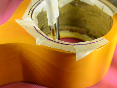

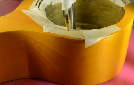

I'm not the best painter and my hand is not very steady, so I made this tool to create even outlines around the clock's body.
Select a pen or pencil you want to use to paint an outline and then grab a second pen/pencil/dowel/knitting needle. Tape them together and make sure the secondary pen/pencil/dowel/needle is positioned higher than the pen. Just look at picture 2, you will see what I mean. You might have to experiment with different pens, because the thickness of the outline depends on the thickness of the pens. Picture 3 shows you different outcomes I got from different pens.
Experiment with different combinations by protecting the clock with masking tape or scribbling at the back of the clock where no one will see it.
Step 3: Make an Outline
It takes a minute to get a hang of it, but it's not too difficult to keep your hand steady and move in short, slow bursts to create an outline.

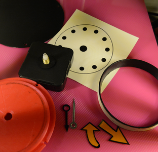

Step 7: Clock Hands
When choosing clock mechanisms, get one with plain, straight clock hands. You want to make your own, colourful, exaggerated and outlined hands and then glue them to the hands that come with the clock set. You need the pre-made metal hands in order for the mechanism to spin properly. Essentially, you will just glue a bit of paper on top of the hands, but the metal behind the paper is still there and doing its job.
Print arrow-shaped hands in colour or paint them with your paint and cut them out.
You want to use thick paper for the hands, regular printer paper won't hold.
Alternatively, you can cut them by hand from a piece of plastic or cardstock. You can also 3D print them and paint afterwards.
When you have the hands ready, make sure they are long enough to reach the hours and minutes on the dial.
The "HOUR" hand is shorter and usually positioned at the bottom or the clock shaft. You want to make a hole at the end of the paper arrow to thread it through the shaft properly.
The longer, "MINUTES" hand usually goes on top of the "HOUR". When gluing this paper arrow to the metal hand, don't glue around the metal hole. That way, when you thread the arrow through the shaft, the paper will cover up the hole at the front. You will get this cartoonish look, rather than having to look at the metallic button in the middle of the mechanism.

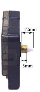

If you want to 3D print your own clock, similar in design to the one I made, here are STL files provided. I recommend you print as is and don't change the dimensions. The internal part that holds the clock is the perfect size for a standard clock mechanism. You will need 4 small screws to secure the everything together. You clock mechanism should have a 5-6mm long shaft- as seen in the picture.
