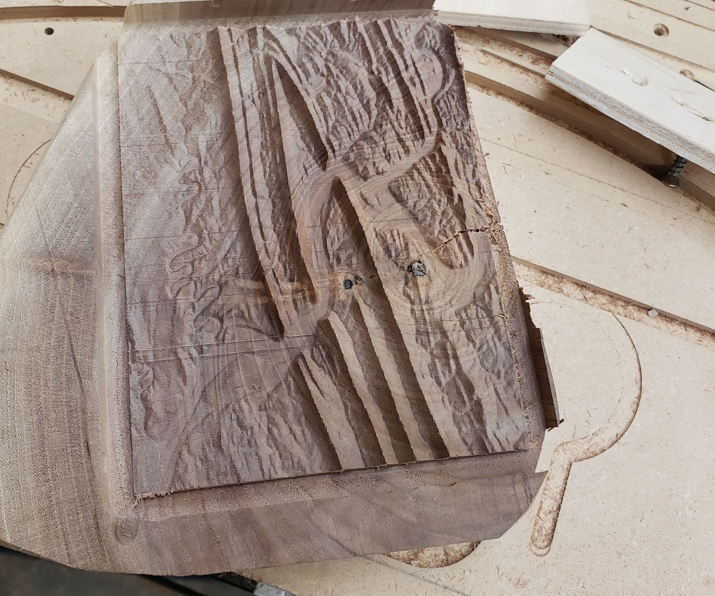

Congrats! We now have a model that Fusion 360 knows how to interact with. The color of your model should have changed from pinkish to greyish (Images 3 and 4). This gives us the ability to assign advanced 3D toolpaths.

Tool selection, RPM, and Feed Rates will vary greatly depending on your machine, material and workholding. The above parameters (Image 1) are for cutting a 4" bowtie out of 3/4" Baltic Birch plywood with a 2 flute 1/4" sharp endmill. After the adaptive clearing select the Parallel toolpath under the 3d menu. I use a tapered ballnose endmill from Amana Tool Item #46282-K and the settings above (Image 2).
It's up to preference, but I found it was easiest to place my origin at the bottom left of the part. The default origin is at the center of the part. If you'd like to change it right click Setup1 and select edit. On the Setup tab select the bottom left corner of the stock using the stock point snap point. Make sure that the Z level remains at the top of your stock (Image 3).
You can now simulate your toolpaths. If you click on one it should give you a preview of the cut path (Images 4&5). If you select both (hold shift) then click the simulate button at the top in the Actions menu you can do a simulation that includes the stock removal (Images 6&7)
