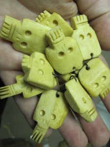

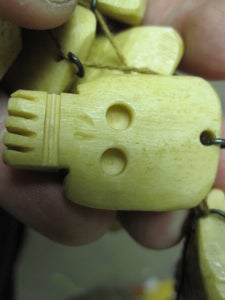

The tools I use in order are:
-Large drill bit (1/4?)
-Small drill bit (1/8?)
-Dremel endmill (1/8?)
-Sanding wheel 1.5"
The cold causes shrinkage in the black rubber gasket, and this loosened the drum. I don't believe that it's supposed to happen, but it happens to me all the time...
-Sanding wheel 1.5"

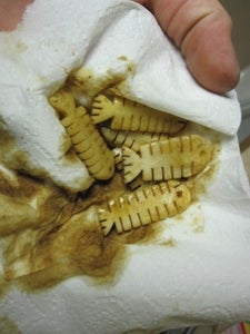

Step 3: Dyeing
Ok, the dying process is the same for this 'ible as it was for the other one.
Mix 1/4 cup white vinegar with 1/4 cup dry powdered instant tea. Mix it up gently and put your bone skull in it for about 5-24 hours.
The vinegar dissolves the top layer of calcium and impregnated those cells with tea. After the bones have soaked in the dye, fish them out and GENTLY rinse them. The dye won't be very stable until the bone is completely dry.
