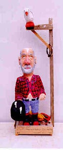

Here is my attempt at a step by step guide to carving a simple fisherman figure. Feel free to use it as you see fit. It can be reproduced for carving clubs, if you wish.
The figure will be a bald fisherman with a beard, holding a sou-wester in one hand with the other held palm up, as though feeling for rain. There are white stains on the sou-wester and on the fisherman's forehead, and a seagull sits on a pole above his head. The title is "Why Fishermen Wear Sou-westers".
A block of soft carving wood, 4" x 4" x 10" will be used for this example. Other dimensions may be used, simply by adjusting the measurements. For example if you prefer to make a 5 inch figure just divide all the measurements in two.

Step 16: Make a Wharf
The finishing touches for a caricature such as this are his surroundings. They set the scene. The accessories bring the concept together, and, like the title, help add to the overall enjoyment of the theme. They also add depth and detail to the composition, providing substance for those who wish to take a closer look.
The Wharf - or base:
I think it is important to develop a feel for dimensions, relating everything back to the figure. Use your judgement in sizing things and placing the figure. I chose a small base.
The same principals of design apply in setting up these scenes, regardless of size. When trying a new concept I like to make the accessories and try them in several different locations before gluing in place.
To begin, you will need some old wood that has been outside and has turned grey in the sun. Cut the wood into strips, about 3/4 inches wide. Next turn the strips on their side to saw again, making two thin strips of wood with one side aged by the sun.
A couple of these strips can be laid flat and sawn again to make narrow strips, which we will use for the ladder (optional) and the seagull's perch.
You can use a hand saw, or a scroll saw, to do this work. Be especially careful if using a table saw or band saw, employing push sticks.
Determine a good size for the base by laying sticks down and standing the figure on it. I used a small 3 by 4 inches frame, but I rarely measure this kind of base. It works better to size it to the figure.
Build a little height to the wharf by laying two cross pieces on each end, then adding two lengthwise pieces. I assemble this size wharf using a glue gun and transparent glue sticks. You could use wood glue for more strength but I have had good success with a glue gun.
Attach the figure to the wharf, slightly to the left of centre. For extra hold on the figure you can drill a very small hole in the wharf and put screws up into the feet.
You can add more height to the wharf. Simply repeat two more cross pieces and two more lengthwise. Adding more height will make it look like a wharf, but be careful not to make it too high.
Make an upright post, from one of the narrow sticks. It will need to be long enough to go from the bottom of the wharf to about 1 1/2" above the figure's head.
Make a cross piece for a perch, establish the length by positioning the figure on the wharf and having the seagull above his head. Glue a triangular support piece in place.
Attach this pole to the back, right corner of the wharf, using the glue gun.
Make a simple ladder with two uprights and two steps, and attach this to the left side of the wharf.

Sand and prime the carved bird with white acrylic primer. Paint the beak and feet bright orange. The wing tops are grey with black wing tips, and the tail is white.
Glue the gull above the figure's head, in target position.
Step 18: The Sou'wester
The sou'wester is shaped to shed water from the head, well out onto the back, so the neck stays dry, ... most of the time.I model my sou-westers after the kind I used to wear. They were black, shiny and stiff, so they held their shape. Modelled after the original oiled leather but made from artificial materials. Quite different from the modern floppy plastic ones, that are usually yellow.
The wood for this should be about 1 1/2 inches by 1 inch by 3/4 inches thick, but I encourage you to simply hold a piece of scrap up to the figure and use judgement on size. You can rough cut this with a scroll saw or simply whittle it out from a piece of wood.
Once you have the basic shape prime and paint the hat black, and glue to the figures hand.

The accessories affect eye travel, just like in a painting. The eye tends to enter this scene with the largest figure (the fisherman) and then should follow a circular course to seagull, down to wharf, etc.
Strive for a balance and the overall affect should not be too cluttered or too barren. If you make a larger wharf you may need to use more rope and buoys to give a pleasing affect.
Make a name tag from a thin strip of wood. Use a wood burner or write the title with fade resistant ink, and glue it to the wharf. Brush or spray your favourite finish over everything, and set up for display. The weathered wood can be left unfinished.
And now, me son, you are a carver of fishermen. :)
I decided to make a limited edition of this theme and I cast a few each year. I show an example in the second picture.
