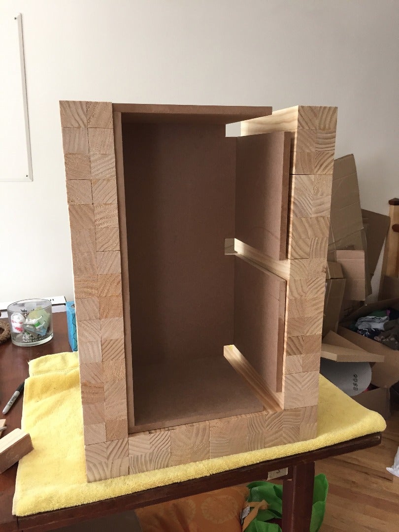

Building a box out of MDF is pretty easy, but remember, this box needed spaces for the lid-openers removed. This meant a bottom with some large notches and five side pieces. The nominal dimensions of the box are 22.5" x 12" x 10".
The box sides are only screwed together for now. I was not sure if I was going to have to disassemble it for my move.

Using the lid thickness to offset the compartment from the sides, I drilled 1/16" holes from the inside of the compartment, into the pine walls for three of the sides. I left the side where the lid-openers go for the moment, realizing that attaching a heavy pine wall exclusively to the two panels might stress their single joint. I drilled out the holes in the pine walls for threaded insert nuts, and drilled out the holes in the box walls for the matching bolts.

The boards used to raise the lid are simply held in place by a combination of dowels driven into the pine wall they but up to and notches in the compartment. The movable boards are slotted so that they are free to slide upwards on the dowels, and are kept on track by the compartment.

Step 8: Assembly Part 4: It All Comes Together
So, apparently the charger for that new drill is defective. Hopefully Home Depot will give me an exchange tomorrow, I am so close to finishing!
Edit: I exchanged the drill. Hopefully this photo sequence of the assembly is helpful. The lids still need some sanding, and to have the bottom layer glued on to reduce the warp, but you get the idea. More tomorrow!
