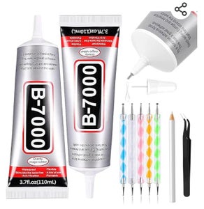

The fourth image shows the adhesive glue used to attach the clean faceplate onto the clear case. (This is not needed if you choose to work on the crystal less clear case). The glue can be found here : https://a.co/d/014dPwl

After the crystal has been removed the paint can be stripped away using a guitar pick and scraping it under water. Once the crystal is clean it can be inserted into the clear case. To insert the clean crystal apply a bead of B7000 glue around the exterior of the outer cavity edge. Once the glue is set press the crystal in and clean any excess that spill out from the edges. Let the glue harden for 24 hours before testing the water resistance.
