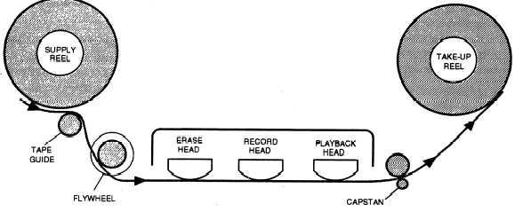

A magnetic head is a transducer that converts the electrical signal into a magnetic field. In audio tape recorders or cassette players four types of magnetic heads are used.
  1. Play Head
  2. Record Head
  3. Erase Head
  4. Record/play Head
Here in this project I am using only Play Head. When the magnetic tape slides below the play head it produces an induced EMF in the winding of Play head and this induced EMF or voltage is amplified by the pre amplifiers and then it is given to Power amplifiers and then Loudspeakers
