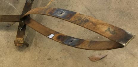

Step 4: Position the Legs
With the bath still upside down and the welded frame in place, it’s time to mock up the legs. This part is all about balancing form and function - and a bit of improvisation.
Weight the tub downto prevent any movement while you work. I used a few heavy objects I had lying around.
Clamp one leaf spring (leg) to the outer edge of the frame, oriented upwards. Use a prop or stand (like a milk crate) to help set the leg to your desired height and angle.
Take a longer leaf spring and place it on top of the first pointing downwards. It should naturally rest against the clamp and hold its position without slipping - no need to clamp the top one. Don't worry if the top leaves overhang too far - they can be trimmed to size later once everything is welded up.
At the outer join, I went with a leg height of about 900 mm, but you can adjust this depending on how high or wide you want your tub to sit.
Repeat this setup around the tub, using eight leaves total (two per corner - one clamped lower, one resting above).
Adjust each leg individually until you’re happy with the overall look and balance. It’s all visual from here - go for symmetry or something more creature-like if that’s your style.

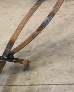

Step 5: Weld the Legs
Weld each leg at the overlap joint using the same process as before:
Once all legs are welded on one side, carefully flip the entire tub assembly over to access the underside.
⚠️ It’s getting heavy now — use help or leverage to avoid injury.
Repeat the same tack and weld process on the underside joints.
In the second photo above, you’ll see I added a small support tab - just a scrap offcut - welded between the lower leg and the frame. Don’t need to be fancy - just strong and well-positioned.The final step in securing the tub is to install the U-bolts onto the side brackets.

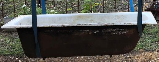

Step 9: Mount the Bath Onto the Frame
With the frame fully welded and ready, it’s time to place the cast iron bath on top.
Lift the tub carefully - I used a front-end loader on the tractor with lifting straps. You’ll need something similar due to the weight.
Slowly lower the bath down onto the frame, taking care to align the bath legs with the mounts points on the frame.
Make small adjustments as needed while it’s still suspended to ensure everything sits level and square.
It helps to have someone guide the placement while one person controls the lift. The cast iron is heavy and unforgiving, so go slow and steady.
