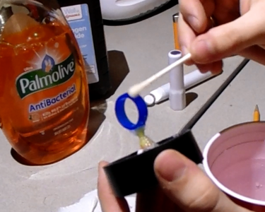

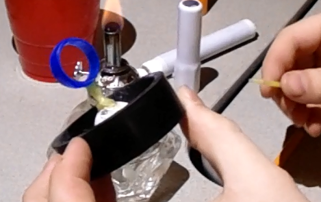

  1. Attach a small sprue to your ring. Do this by taking a small rod of wax and fusing it onto the ring in a non-critical location. Use multiple sprues if necessary for larger and more complex parts.
  2. Measure the mass of the wax and sprue. Record this number down somewhere for future reference. You will need to measure out your metal based on this quantity.
  3. Affix the sprue and ring to the rubber sprue base. Keep the sprue as straight up and down as possible.
  4. Using a 50/50 mixture of Hydrogen Peroxide and Dish soap, apply generously to the wax ring (cotton swab is useful here). Allow to dry for about 10 minutes. This is the "debubbleizer" which prevents air bubbles from forming in the investment compound and ruining the part. After it drys, dunk in water to remove excess residue and to check for any bubble formation. Repeat as necessary until bubbles no longer form on part.

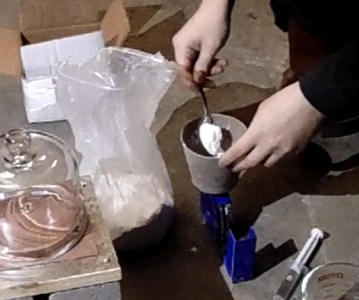

  6. Using a measuring cup, measure out the amount of water you will need for mixing with the investment. Do this based on the manufacturer specifications of the powder you use. For my powder and flask size, I needed 100 ml of water with 150 g of investment. Keep a little bit of water on the side for fine tuning the mixture.
  7. Put on your mask! At this point you will be working with investment, which contains silica. You REALLY don't want to breath this in (it would be like sanding down your lungs and destroying them over time!).
  8. Using a balance, measure out the amount of investment you need into the mixing cup.
  9. Add the water to the investment and start the timer. There is an 8 minute working window - don't go over. Here is the suggested process for the powder I use:
    • 3.5 minutes mixing by hand in the cup. You want the mixture to be thin enough to be able to pour into the flask and surround the details of the ring, but not too thin. Fine-tune by adding bits of water or investment.
    • 1.5 minutes degassing the investment (in the cup) under vacuum. This will help remove air trapped in the investment. Shaking/vibrating the chamber a little can be done to improve results.
    • Pour the investment into the flask, running it down the inside and not over the ring (you don't want to knock it out of alignment).
    • Remaining time is used degassing the investment (in the flask) under vacuum. Shaking/vibrating the chamber a little can improve results.
    • At the 8 minute mark, put the flask in a convenient location to sit for 2 hours and harden.

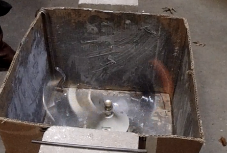

  1. To prepare the centrifuge and keep it safe to use, take the wood sheet and screw the centrifuge to the center. Use the cardboard box to create a barrier around the centrifuge to block any flying objects from escaping without impeding the centrifuge motion (the more enclosed it is, the safer). Affix with glue/caulk.
  2. Measure out the amount of metal you need. For converting from wax, take the mass of the wax and multiply by ratio of densities between the wax and the metal (for Sterling, the ratio is about 10.4) then add a little extra to make sure there is enough (some might fly off, not go into the mold, burn off, etc).
  3. Balance the centrifuge out with the metal and flask (without rubber base) in place. This will help prevent molten metal from flying everywhere (as I incidentally found out) and give a better cast.

  5. Wind up the centrifuge to its maximum number of turns. Use the locking mechanism (mine had a pin) to keep it wound.

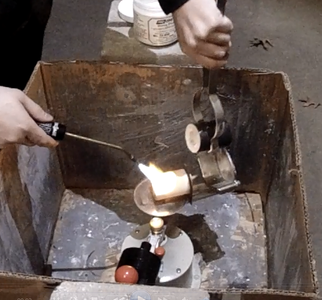

  6. Start heating up the centrifuge crucible without any metal inside - this will help significantly with melting. Caution: Oxygen + Propane flame is HOT! Using MAP + Oxygen is REALLY HOT! Use common sense and get help if needed when using the torch. Be safe (tip: never start the flame with the oxygen on). You want a relatively "reducing" flame (one that is oxygen deficient) when working.
  7. Once the crucible is warmed up, add your metal. Heat up until the metal starts to glow red (such as for Sterling) then add a small pinch of borax powder. This will help prevent too much oxidation of the metal. Keep heating the metal and stir with the carbon rod to distribute heat. Note: for Sterling, any green flame is Copper being burned away - try to avoid too much of this.
  8. Hopefully the kiln is near by and you can quickly grab the flask and put it into the centrifuge while still heating up the metal. Use help if needed.
  9. Once the metal melts down, keep heating for about 30 more seconds. Then, release the mechanism and let it spin! Caution: Be safe at this point - expect metal to fly off, so wear safety glasses and make sure your barrier is in place to stop flying objects.
  10. Allow the centrifuge to slow down to a relative stop. Pull out the flask without inverting it. Let it cool until you can no longer see any red glow from the protruding metal, then take the flask and dunk it in the bucket of water, shaking back and forth. The ring will fall out to the bottom. Once cooled, go ahead and pick out the ring and flask and clean them off. A dark grey oxidation layer is common and can be removed easily in the next section.
