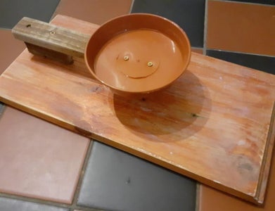

Our cat needed to wear funnel collar after an operation on his tail. It was in place for a week. The collar made it difficult for him to feed because it pushed the food tray away as he tried to eat. This device lifts the food bowl up so that the collar slides underneath the bowl and the cat can reach the food.

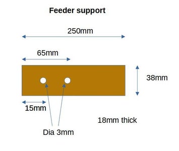

Step 1: Cut Out Pieces
Dimensions are approximate. I used an old shelf for the base.

Step 3: Assemble the Feeder Support
Two 38mm screws are drilled in while holding the feeder support arm centrally in place.
Step 4: Add the Feeder Bowl Holder
Drill the two 15mm screws through the drilled bowl and into the the feeder holder.
