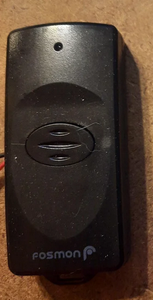

remote on/off control for electric device (Fosmon C-10683) https://www.amazon.com/Wireless-Fosmon-Electrical-Weatherproof-Included/dp/B072F9DGRL?th=1 If you get another kind, it should be a one-button module -- one press to turn the item on, another press to turn it off. This particular one needed a few seconds to "pair" once plugged in, so check the instructions.

The remote control normally activates a device when the button is pressed. Then turns it off when pressed again. The change is to remove the manual button press and instead allow the relay to activate the remote for the signal. (I think you could connect the device's wires directly to the relay and eliminate the remote, but I'm not sure about working with 120v or if the relay would handle that current, so I went the safest route.)
Remove the battery if there's one in there and pop apart the remote module.

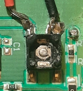

Pop the button out - this will expose the button connection below it.
The button has four connector flanges. Two of them are actually dummies so you don't need to do anything with those. Solder a positive and negative wire to the active poles. It doesn't matter which is which.
For neatness' sake, cut a little exit hole for the wires in the side of the remote.
Pop the remote back together and put the battery in it.
