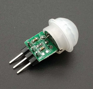

The mini PIR module has all electronics integrated in the PIR detector and can operate on a supply voltage of 2.7 to 12 Volt. Its range is limited to about 3-5 meter which is sufficient for my purpose.

- 1 mini Passive Infrared Module (PIR)

- When the PIR detects movement, it generates a pulse on its output which is connected to the external interrupt pin of the PIC. This event will wake-up the PIC from sleep and will reset a timer. The timer will be reset with each detection of movement by the PIR.
