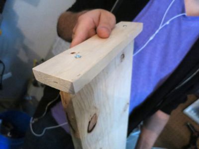

We started by cutting our main piece from a 1×10 to about 23″ long (long enough that Mochi would have room to sit on it while pulling her claws). I think as long as you have a piece that’s big enough for your kitty, it should work just fine.
Next we cut two 11″ long 1×3 pieces that we screwed in at either end of our plank. We used two screws per side, like you see in the illustration above. If you want to be fancy, you could countersink the holes with a countersink bit or larger size drill to have the screws hidden. The 1×3 pieces overhang length-wise about 1/2″ on each side.
The purpose of these two end pieces was to give the twine something to hold tight against (we worried that without some kind of footing at either end, the twine might slip off the edge).

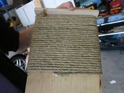

Step 3: Wrap Rope/twine
Next we drilled two holes through the main body, picking one corner on each end (see graphic above). We chose a side of the board to be the back, threaded the twine through our drilled hole, and tied a knot on the back side to secure it.
After threading our knotted twine through the hole, we wrapped it tightly in circles around the board. We didn’t use glue because we thought Mochi might not like the smell. Plus we wanted the twine to be removable in the future if she roughed it up too much and we needed to replace it.
Annnnnd then we ran out of twine. Which is what we get for using a roll of it we already owned with an unknown amount left on the roll. At the end of the twine, we did a couple quick staples with our staple gun to secure it to the back side of the wood. The staples will be easily removable (with pliers) if we need to replace the twine in the future, and they should be safely hidden on the back side. If you are worried about the stables falling off, then glue could be used, or even a screw through a knot in the rope.
Luckily, we had a second roll of twine so we repeated the same process on the other end of the board. It also was not enough to complete the board, so we stopped wrapping when it was about the same amount of coverage as the first piece of twine.
I actually consider it a happy accident because we kinda like how the wood looks in the middle. Plus, Mochi is likely to only pull her claws at either end anyway because of how she sits on it. Though when we replace the twine eventually, we might try doing the full board.
